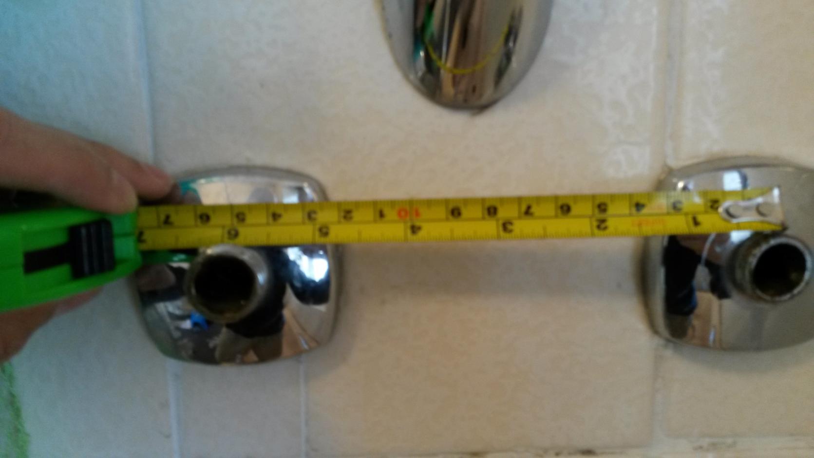

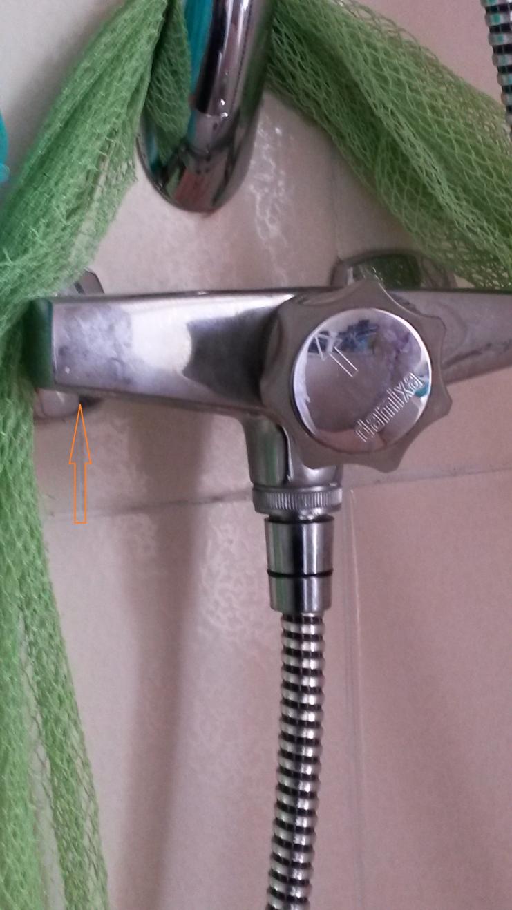

I recently converted from a gravity fed system to a combi. I have a manual mixer shower that has now developed a dripping shower head when the shower is turned off which I'm assuming is due to the increased pressure (the hot and cold pipes to the shower run through the loft and then down to the shower). Theres also a small weep between the backnuts that fasten the shower valve to the inlets.
Normally I would just replace the shower valve to one that is suitable for high pressure systems. But my inlets are z connectors whiche have:
1) G 1/2" (all the new shower valves are G 3/4" compressions type)
2) Inlet centres are 152mm (all new shower valves have standard inlets of 150mm)
So without stripping back all the tiling and doing a new fit its difficult for me to upgrade to a new shower valve.
I was thinking would fitting a flow regulator similar to the ones that fit between a shower valve and shower handset (see link below) if it was fitted between the inlet and shower valve instead, would it reduce the pressure to the valve due to a decreased flow rate?
