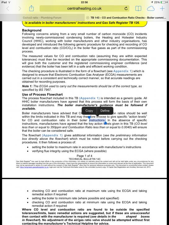

For some reason I can't upload a picture :/ but it's from Gas Installation Technology by R D Treloar
Last try. This is from NICEIC CITB Domestic Gas Safety On Site Guide.
I think we will image.jpghave to agree to disagree as image below is from tech bulletin 143.
I would trust a technical bulletin over viper everyday of the week.
Not sure then mate but if you look at the title when you click on Tb 143 it says when commissioning condensing boiler with air gas ratio valve. Can't find tb146 so will have a look tomorrow

for a open flue boiler its 0.004,
for a combi its 0.008.
unless otherwise by m.i.
thats from the latest niceic book!
