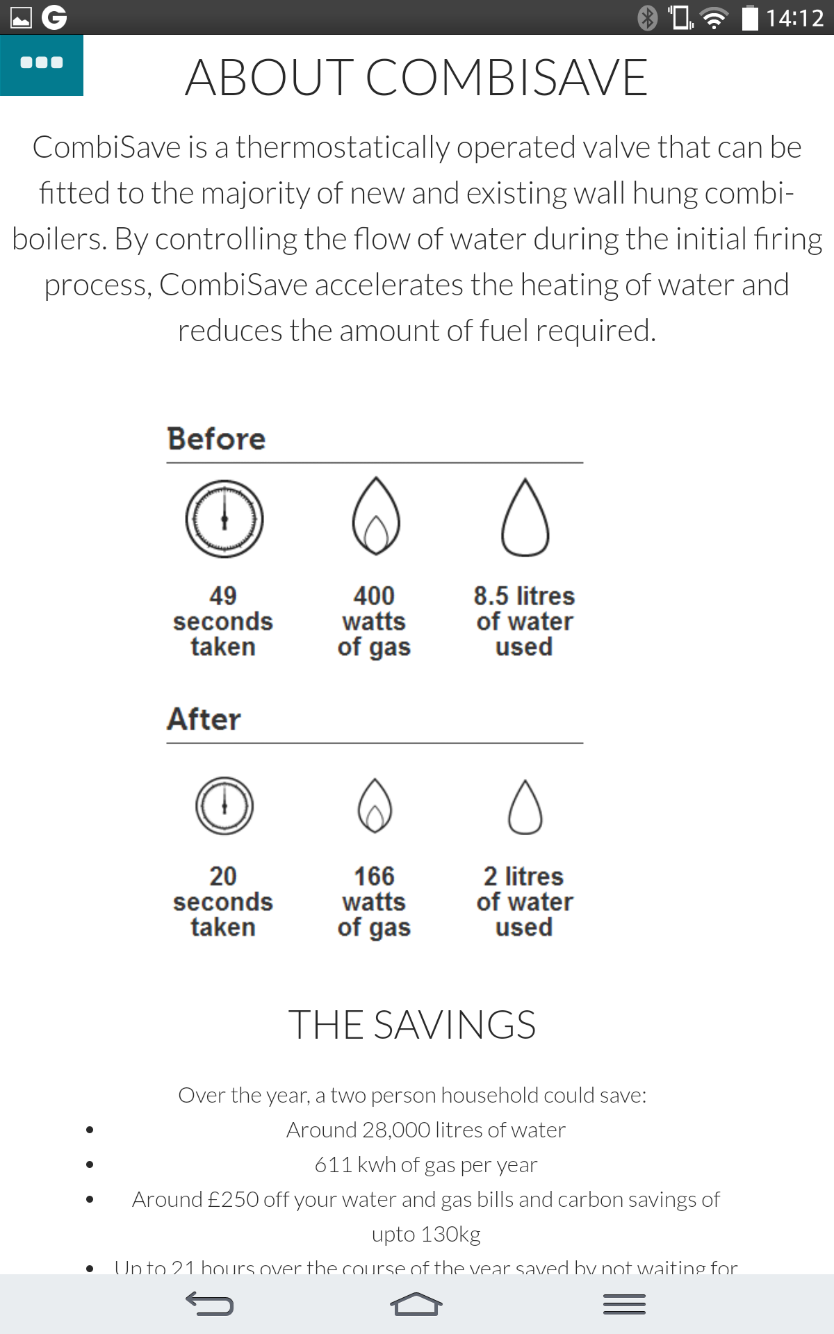

Is there it something like a combi smart/ flowsaver ... I've installed them ones and was quite impressed. It helps to reduce the wastage of water ...
This is what you mean Ronny combi save cost about £50 but can save that and more per year . cheers kop

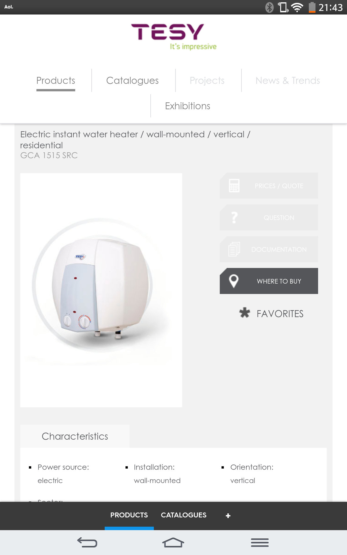

The op asked for options shaun thats one that is proven to work the duo tec has no pre heat . Ariston unvented under sink water heater is another if you want point of use but only 10 litres so abit limited , at some point everything fails that is what keeps us in bissness i wouldnt have a problem fitting one . cheers kop
