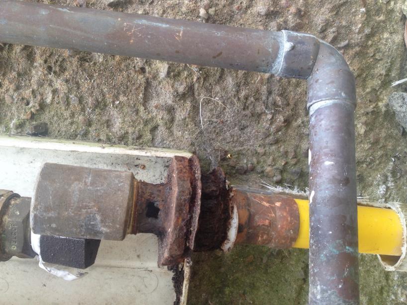

I got called out to a gas leak after SGN (transco) had attended and made safe.
As you can see from the photo theres 4 different types of material, copper, iron, steel and plastic.
Ive managed to cap off the supply going to the plastic pipe, this feeds the cooker and fire at the other end of the house.
can anyone give me a help in identifyinga part that will take from from 22mm copper to the plastic pipe, (25mm?)
Philmac gas universal compression coupling. Plastic not permitted inside dwelling or above ground if exposed to uv
