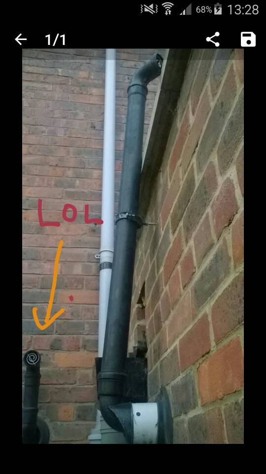

Best part is directly below you there is another flue which would be exiting in the same direction the way the 'problematic' flue was angled.
So
A question...
Whose flue is the other one ?
And have you complained about that too ?
Frankly the more you go on and the more images you add shows you in a worse light than previously imho
Is that here and I don't mean to be derogatory but is this a wind up. The pictures are just showing a catalogue of oddities with all the boiler installs at the property ???
Can I once again suggest that you get an independent gas safe registered engineer to take a look
The other flue serves my property and I have full control when it comes on and off. It used to disperse fairly well as it is pointed away from the rear wall and was well below the previous party wall height. Since the neighbours extension was built my flue is boxed in and has become problematic. You can see the frame which used to support the canopy over the kitchen door in one of the pictures I posted. The canopy was removed by me to try and help air flow but it didn't help and so my gas boiler is never used. Electric room heaters and electric immersion heater keep the water hot and the house warm. If you doubt this I've upload a screenshot of my suppliers energy efficency comparison for my home. My last gas bill I had was 371 kwh (from 15 sep to 1 dec). This is for a 3 bedroom terraced house so you can see how little gas is used (98% less than similar efficient homes). And yes I have complained about my flue but it is apparently within the legal requirements so I have to live with it. Whereas the neighbours flue makes a bad situation even worse because I can't open my bedroom window. It might sound off to you why I put up with it, but I've lived here too long. The apple tree in my garden (in a previous pic its in blossoms) was planted as a sapling by my previous wife before she passed away as a living memory of her.Now it's a proper tree and I can't take it with me so here I stay.
