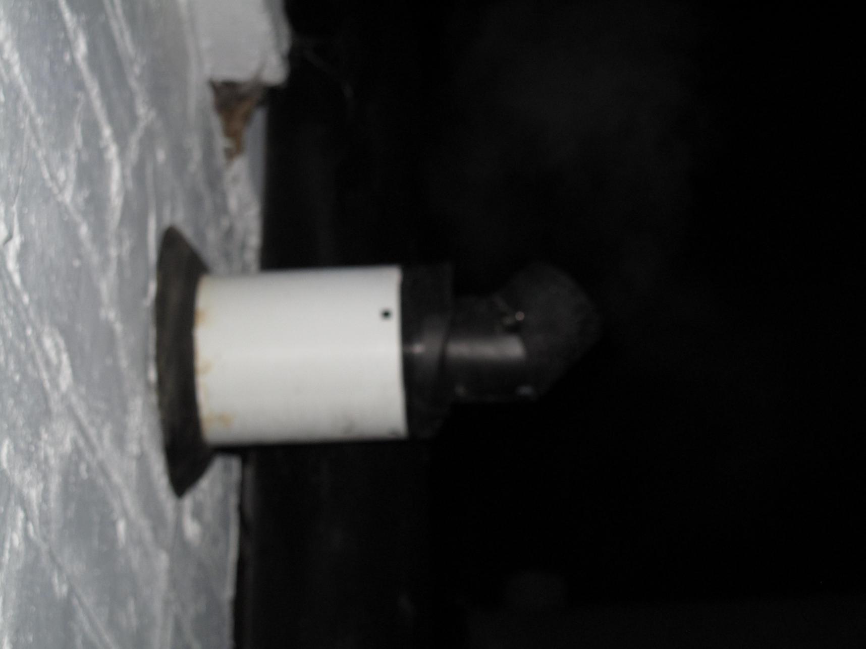

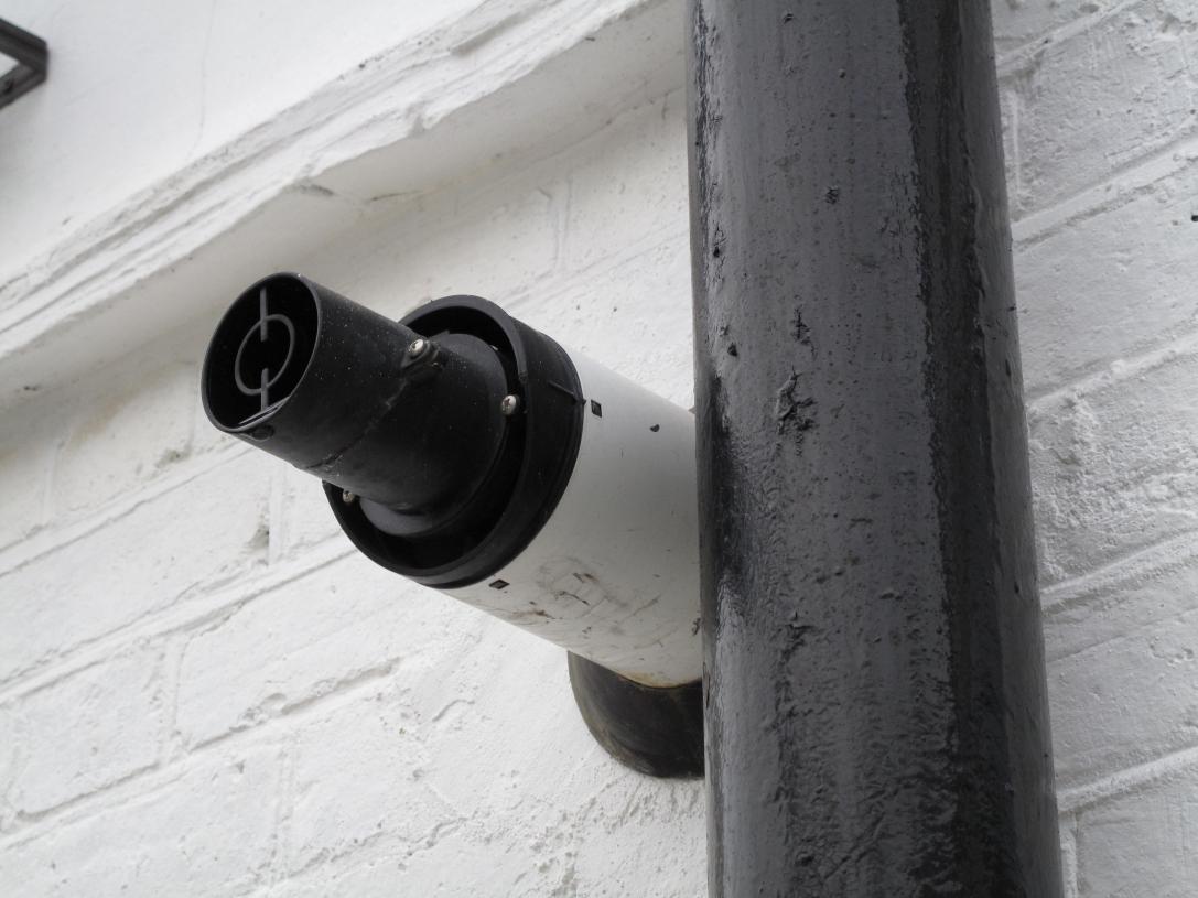

Hope somebody can help me with this query. We have a Worcester Greenstar 28i Junior combi boiler. Works well but I think the flue has not been installed correctly as it drips onto the patio, especially in this cold weather. From what I've read I think they should be installed at a slight angle so the condensation can run back to the boiler but our looks to be horizontal and our patio is suffering. I've included a few pictures to show you what I mean.
What can I do to stop this? Sure there must be a spare part to up the angle.
Any advice would be much appreciated!

During the summer the flue will need to come off and a bit more brickwork chiselling off above the flue so the angle can be increased. Nothing you can do at the moment other than putting a bucket underneath!
Thanks for the quick reply! Would you advise using a deflector to increase the angle at the end of the flue until I get it fixed? I've just had a look at it and I can change the direction of the end piece to point to 1 o'clock instead of 3 o'clock. Advice appreciated.
Mark
I was about to say that but although the recommendations state 300mm, judging by the length of it and the fact it is quite exposed lolcation I don't think it's anything to get overly concerned about.

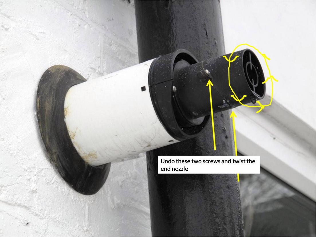

As a temporary measure, you can adjust the angle of the end nozzel, can you see in the picture there is a split in the middle of the end tube which is at about 45 degrees?, undo the 2 screws on the end of the nozzel and twist the nozzel to make it face upwards.

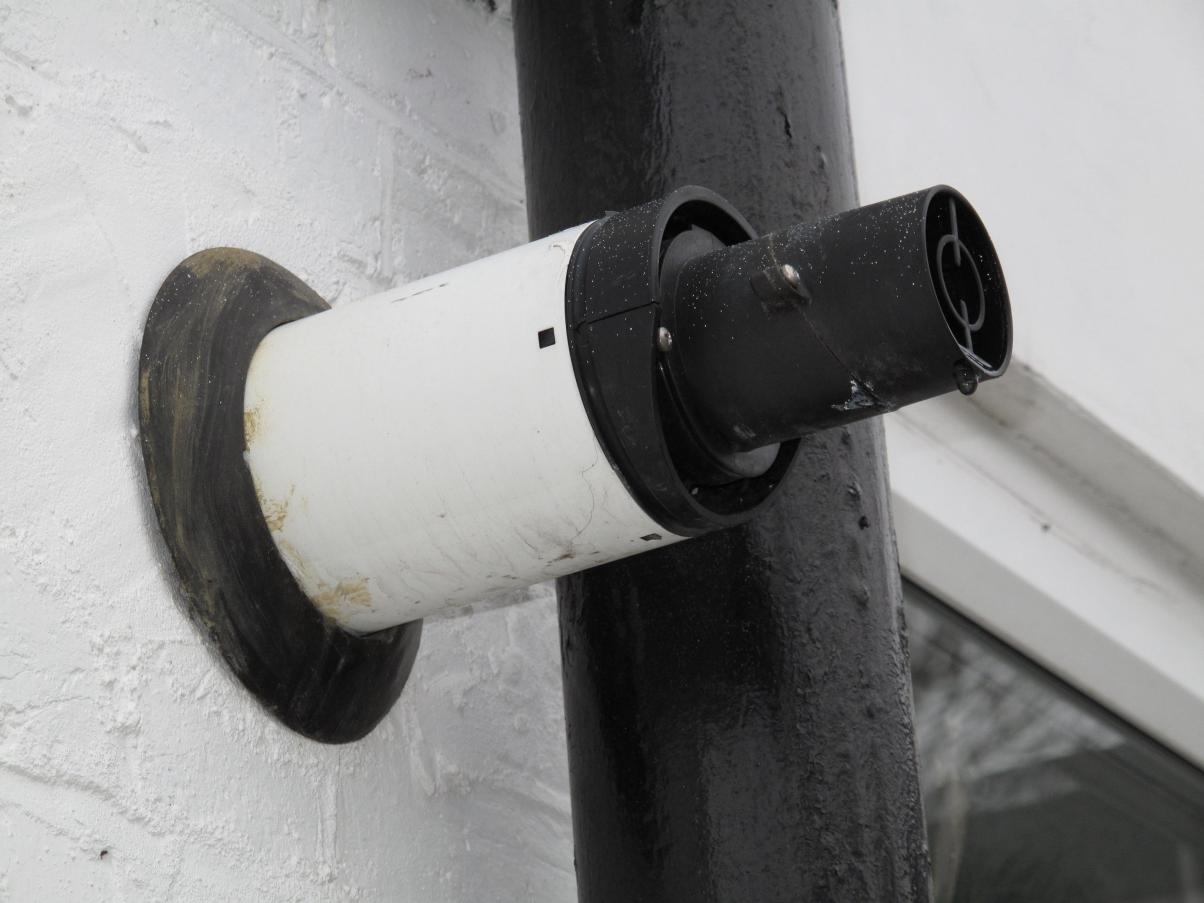

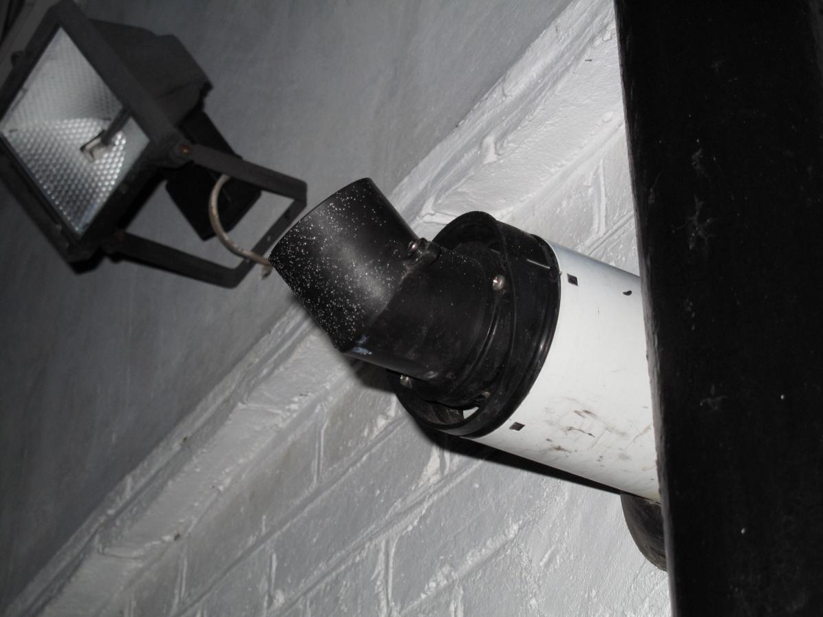

Hi folks,
Thanks for the great advice. I've just popped outside and made the changes Blackcatgas recommended (see pictures). Probably worth sharing just in case anybody else has a similar problem. Will change the angle when the weather gets a bit better.
Thanks once again!
