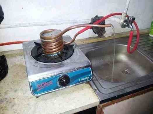

it is amazes me that sombody thought of doing it that way ! it wouldnt come to my mind to pipe it like that ! creative !

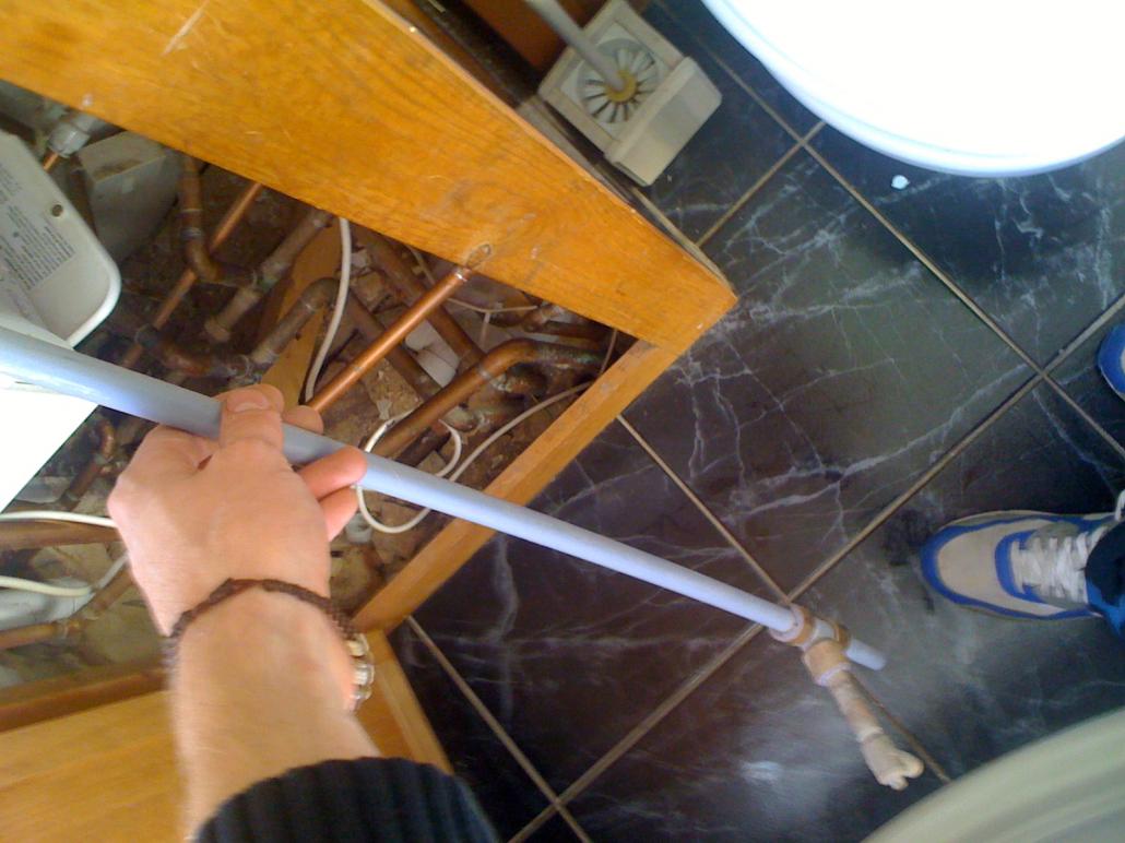

IMAG0059.jpg. Went to service a boiler I put in last year and he said can you just check something else,needless to say he fitted it himself and used the hose from his old ffree standing cooker

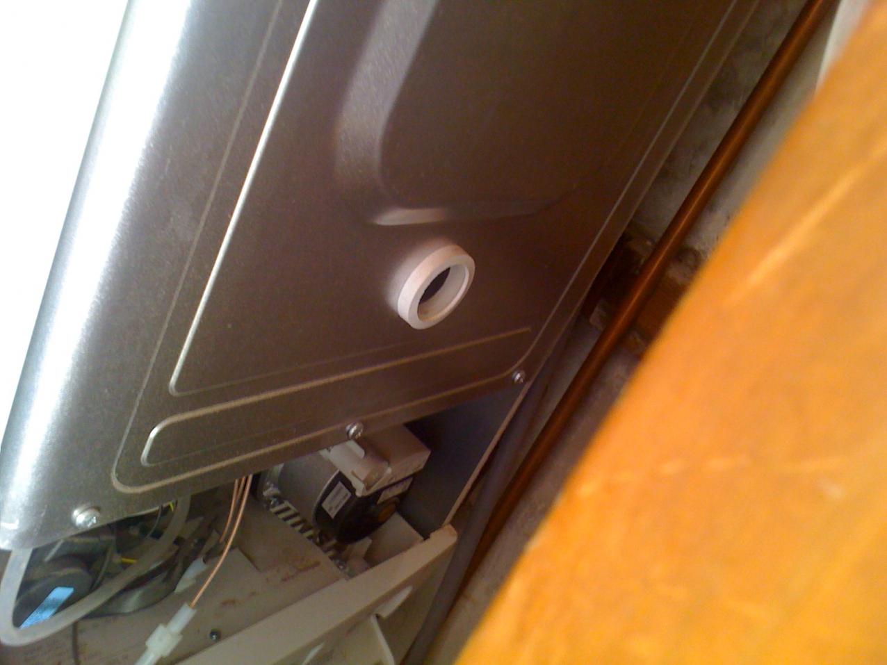

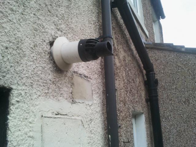

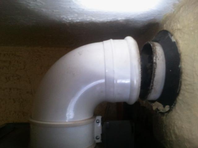

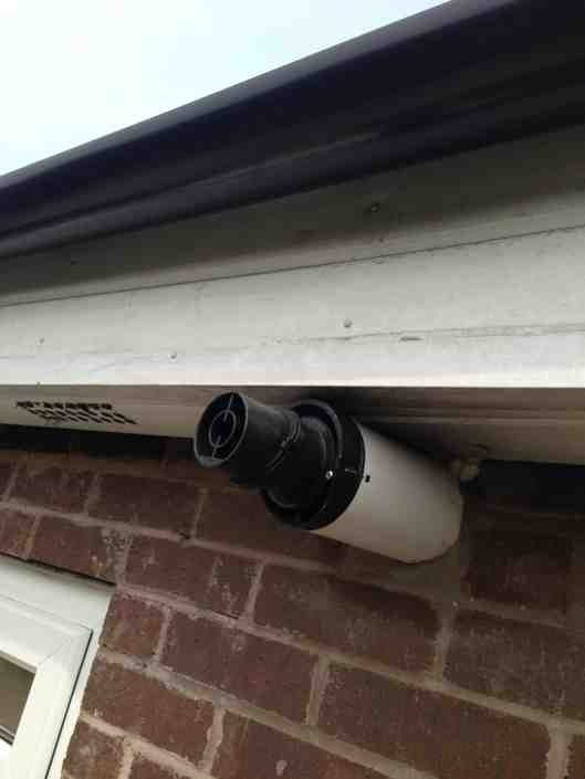

saw the flue outside when doing a job next door today knocked on customers door and then shock when i looked inside.cust wasnt even aware and was complaining of headaches.
Of this photo I can se only air intake tube separated ... And. I sign of soot on the ceiling above flue ! Did u do a co reading in the room to see if it was leaking and co and CO2
its not the clearest photo but when i went to check if it was connected at all it came off in my hands from outside as it wasnt sealed either side of the wall. never thought to take a reading before i just cleaned all the fluff and crap off and refitted then did my checks and a reading after to check it was safe.

cust was just parking up when i collared her.
showed her what was up. went inside told her she was lucky to be alive and she just said i wonder if thats why ive been getting headaches. i told her i could fix it but i couldnt leave it as it was,without capping it off. she told me to fix it whatever the cost. and i did. and i sold 2 co alarms aswell as her mate was with her and took a business card.

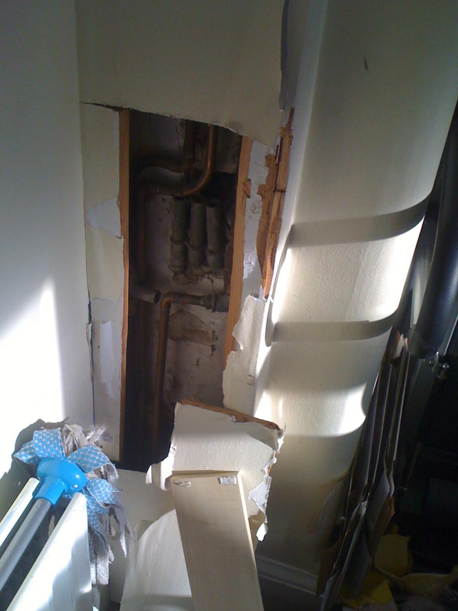

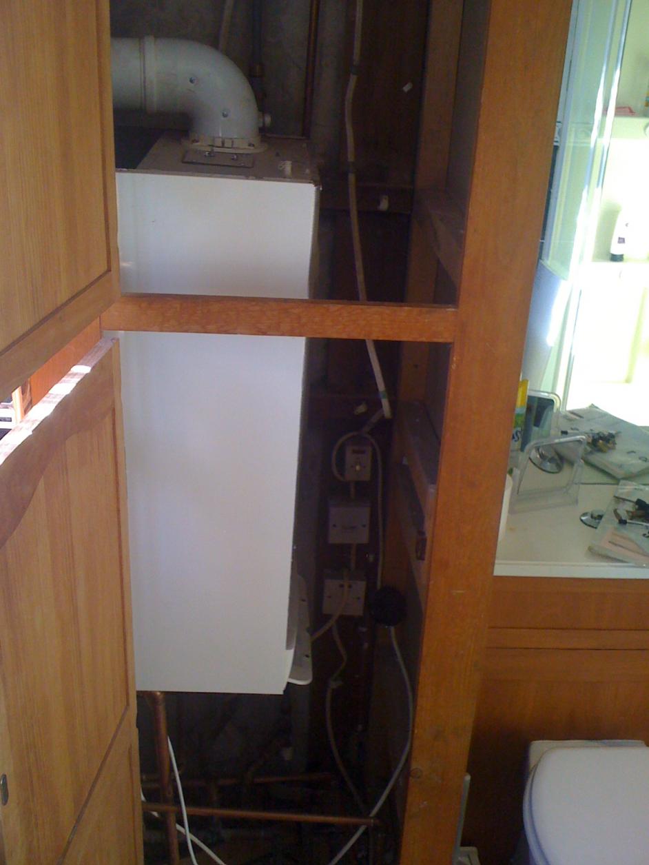

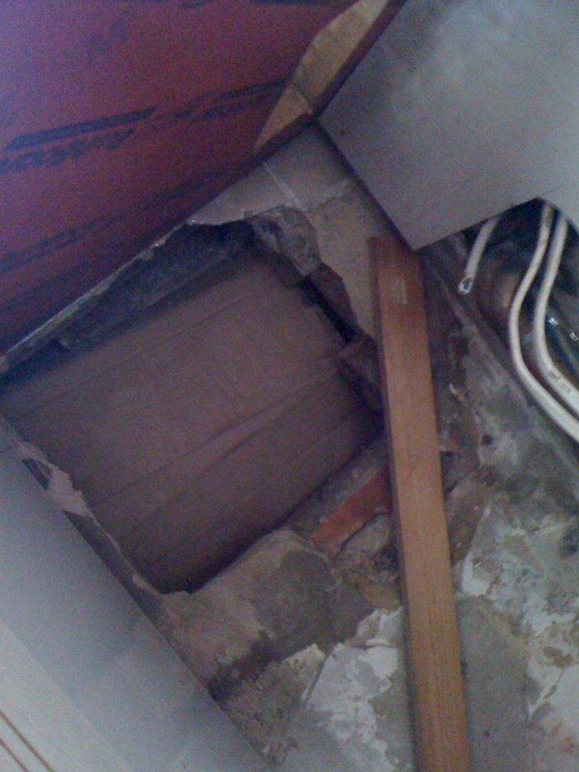

Boiler Install

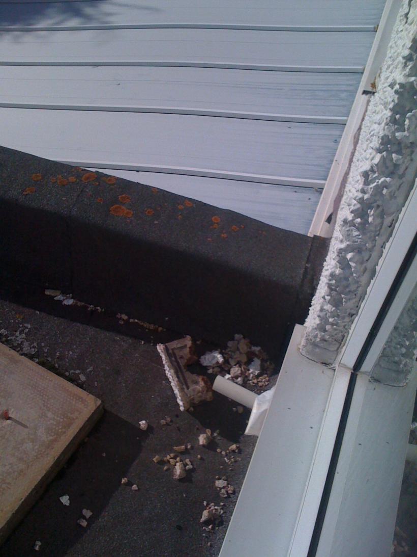

Boiler was less than a year old. Fitted sideways so no acess to change anything at all on the boiler. Main heat exchanger blocked due to installer not flushing system. Huge holes left in walls, condence termiantes on felt roof, pure lazy as it could have been run 3 meters into a drain. Flow and return run in 15mm. Biasi refused to do anything obviously as installer had left no acess and fault was due to blockage.
Ended up fitting new boiler on rear wall so now at least you can change a part if needed. Flushed system and fitted a magnaclean.057.jpg058.jpg059.jpg060.jpg061.jpg064.jpg062.jpg
Ended up fitting new boiler on rear wall so now at least you can change a part if needed. Flushed system and fitted a magnaclean.View attachment 8546View attachment 8547View attachment 8548View attachment 8549View attachment 8550View attachment 8551View attachment 8555
