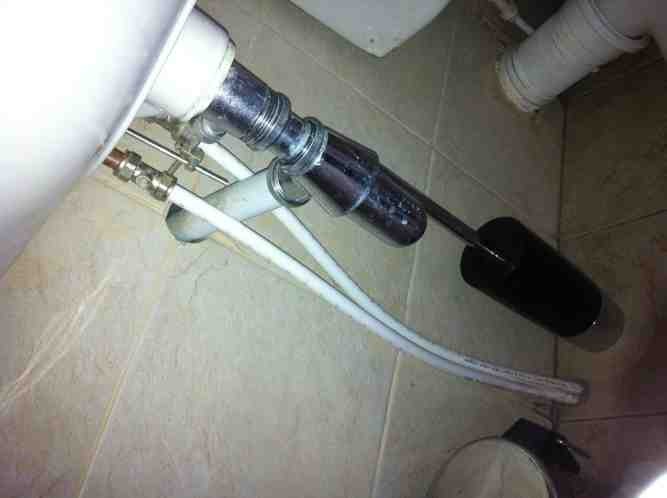

That's the main earth bond so it means the rest of the system is not bonded. All that does is earth just the stop tap and is actually more dangerous than not bonding at all. They have turned an isolated metal fitting into a route to earth. The rest of the plumbing in the property is copper or galvanised iron. Should there be a short to the pipework and someone touched the sink and that tap they would have completed the path to earth.
Gotcha, bondings a bit of a mine field. seems every spark has a different opinion. the fact all new sevices are plastic doesnt help though because the earth leakage has to go to ground which is like you say through a poor water conducter and in the case of gas meter bonding to nowhere exept back up to a hopefully bonded pipe.. unless pme is involved of coarse.
