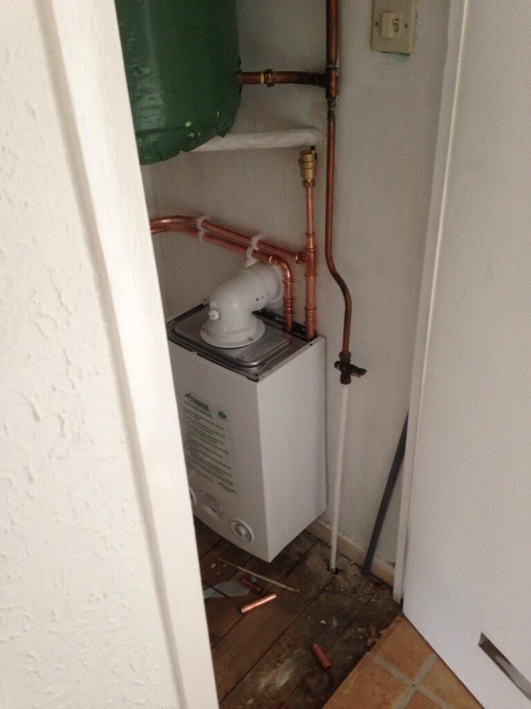

Ega pipe work on half landing
What company installed this? this looks familiar from my apprentice days hahahaa
