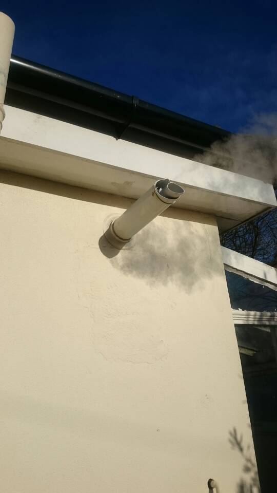

Ingenious use of an old boiler flue to run an extractor fan. Approx 4 metres straight up to peak of roof. Funnily enough it doesn't work
Same roof they have re routed the soil pipe by means of a dryer hose around some botched loft flooring. Very little to support it and they can't understand why the flashings moved and they now have a serious leak. image.jpg
