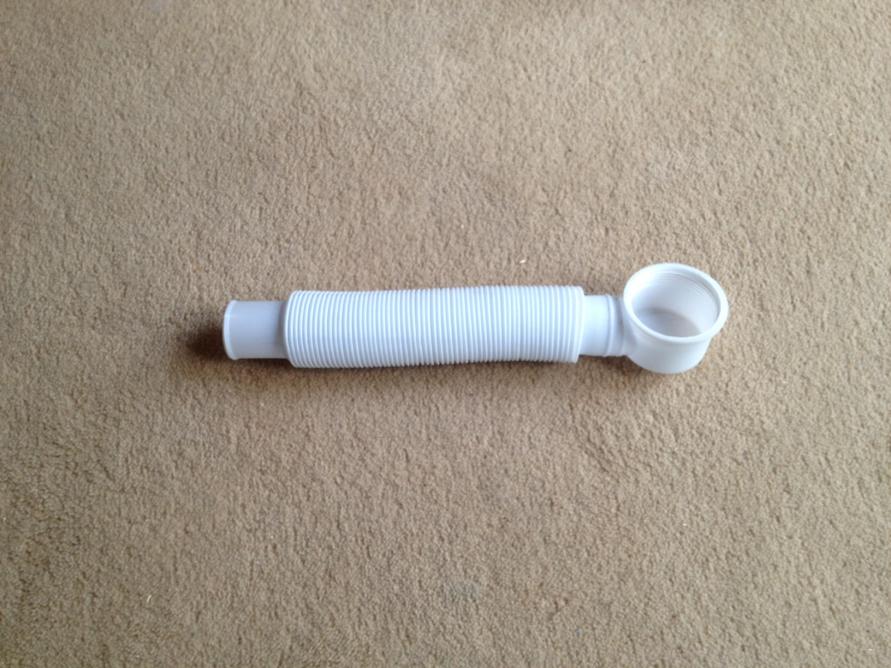

I hope someone can shed some light. Boss Lady bought a bath that weighs 27 stones for our loft conversion and I have been lumbered with the job of fitting it. Mate who is a plumber has helped me get waste pipes etc installed but doesn't want to know the bath, and who can blame him.Now that the joists have been re-inforced and the 25mm WBP ply is down and we somehow managed to get the bath up into the room ( long story) I have decided to have a look at the bath. I always thought I would have to connect the drain from underneath (ie via the ceiling in the kitchen) so no probs with accessing the 40mm waste pipe.See the attached picture. The bath has a sort of void underneath about 45mm high. Connected to teh plug hole is a flexi connector which can be bent and extended to virtually any position. My problem is how to connect this to a bath trap. the end has an outside diameter of approx 32mm. There is a run of about 3 metres so I want to use 40mm Waste pipe.Any suggestions / help would be gratefully received :rolleyes2:
That looks like part of the overflow. I reckon you need to go and buy bath waste kit.
hi welcome gcgold. i believe that you form a trap with the flexi part it should come with a sort of clip which is attached to the flexi to keep it in position. you then get an adaptor to go from 32mm to 40mm then away you go!
Feel like throwing the bath away - except I cant lift it coz its so heavy. Will source a Macalpine bath waste kit now . Many thanks for your prompt responses.
