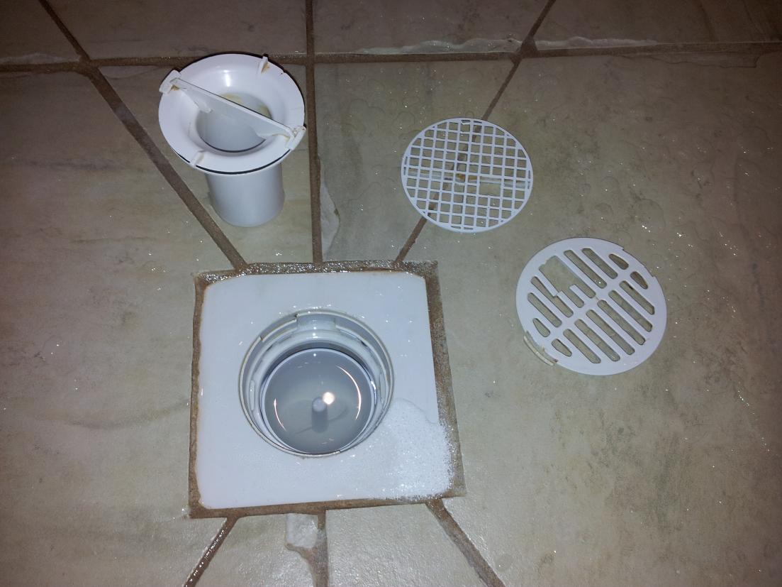

Saniflo deals with water from the shower, bath and washing machine in the next room. Bath and shower seem to drain fine so seems that the issue is somewhere between he shower plug and the saniflo. Here is a pic of the trap dismantled:
Finer grate thingy sits on top of trap insert, bigger grate thingy on top of that, and yes it looks like it's been stepped on but surely that's just cosmetic damage that shouldn't impact what's going on underneath? Sorry don't quite understand how this all works!
I have already tried running a bendy piece of thin plastic around the rim of the inner container that's holding water in the pic to see if anything is stuck down the side but seems to be clear. Haven't tried anything with a hook on the end. As the inner container doesn't seem to be removable I can't even work out where the entrance to the connecting pipe is underneath (i.e. whether it is straight down underneath or whether the exit pipe would come off to one side).
I'd be open to changing the trap mechanism if that would help but can't see how that would be done without some more invasive work!

Don`t see that you can do anymore at the shower end Helen and doubt the wet vac idea would be worth trying. Shame the Sani is difficult to get too as you could wet vac from that end at least you haven`t got the Sanimatic shower floor pump which was rubbish and has just been replaced hence my question in #12.
Different pumps start at different water levels in the tank so if the problem started as soon as the new one was fitted then that might be the problem. I mention this because of the washing machine which tells me that you should have the Sanibest but that model has a high ativation point. I seem to remember a post last year where the advice was to cut 10mm off the bottom of the tube part to allow water to flow away better but don`t do this until another member say`s so in case I`m wrong.
