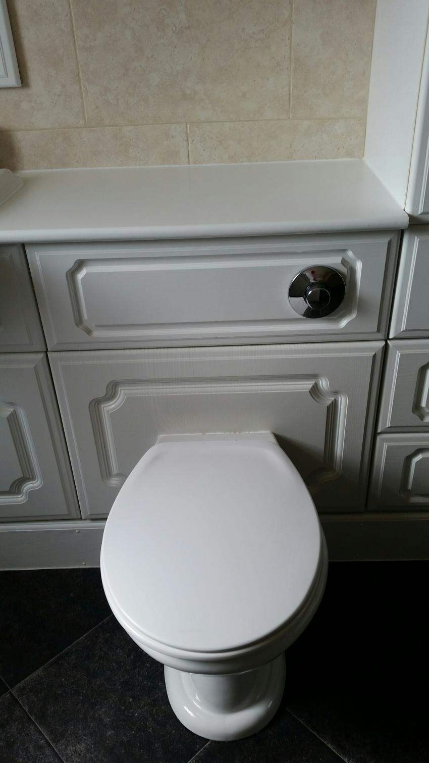

A small amount of water in the toilet in my bathroom runs continuously down the back of the pan. I am assuming a seal needs replacing.
I am having difficulties accessing the cistern though as it is concealed under a worktop.
I have attached a couple of photos.
Any advice on how to get into the cistern would be greatly appreciated..
As above the slim panel will come forward using a slim screwdriver, have one hand ready so the panel doesn`t fall as there are tubes connected to the cistern valve. See if you can pull the tubes off the button and put panel to one side then behind is a (Blue?) plastic panel giving access inside the cistern to isolate the incoming water. Hope you don`t have massive hands as access to the cistern valve is tight.
