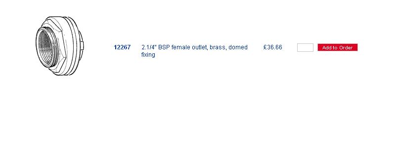

Other alternative is this
and a top entry.
