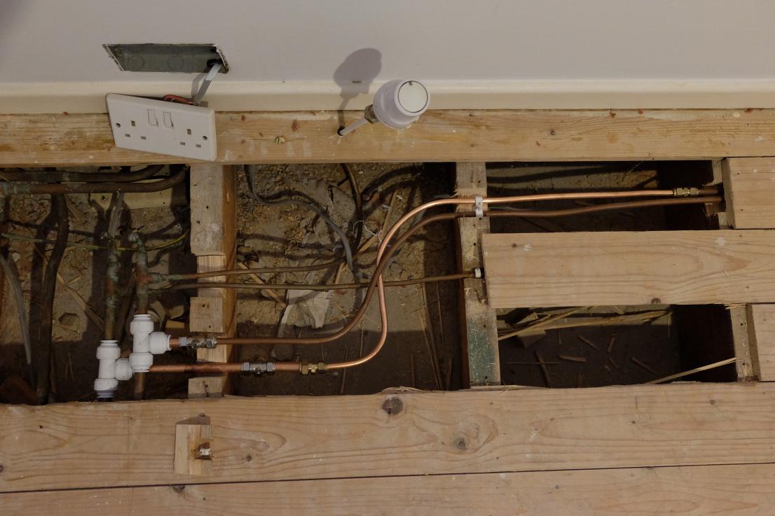

Bashed I think.
Didn't check under the floor before the job but no real reason for the notch to be there apart from to take that pipe.
I suppose I can fix what I think needs fixing and if anything goes wrong then go back to him.

Check out the actual span of the notched joist. The notch has reduced the 170 x 50 to the equivalent of a 100 x 50 joist. If the span exceeds 2.5 metres structural integrity has been compromised. The span is the clear distance between supports and should not be confused with the total length of joist.
I was on a job once and the hole backroom floor was like a trampoline, after someone had notched 5 22mm pipes in a row and they where all tight notches
Joists span 3.4m by a rough estimate. The deepest notch is 15" out from the wall.
Apparently he could fit the new radiator without draining the system by doing it this way. He put a bung in the header tank somewhere and switched off the heating allowing him to make the cuts, put the valves on and then do the rest of the work...
Another pic of the layout (this is in upstairs bedroom and the new pipes are teeing off to the downstairs radiator):
size of them notchs for 10mm pipes? , every thing else aside I really cant stand the ticking time bomb's full of flux corrosion after the tees?!!! did he not mention anything about that? i recommend you get them cut out,

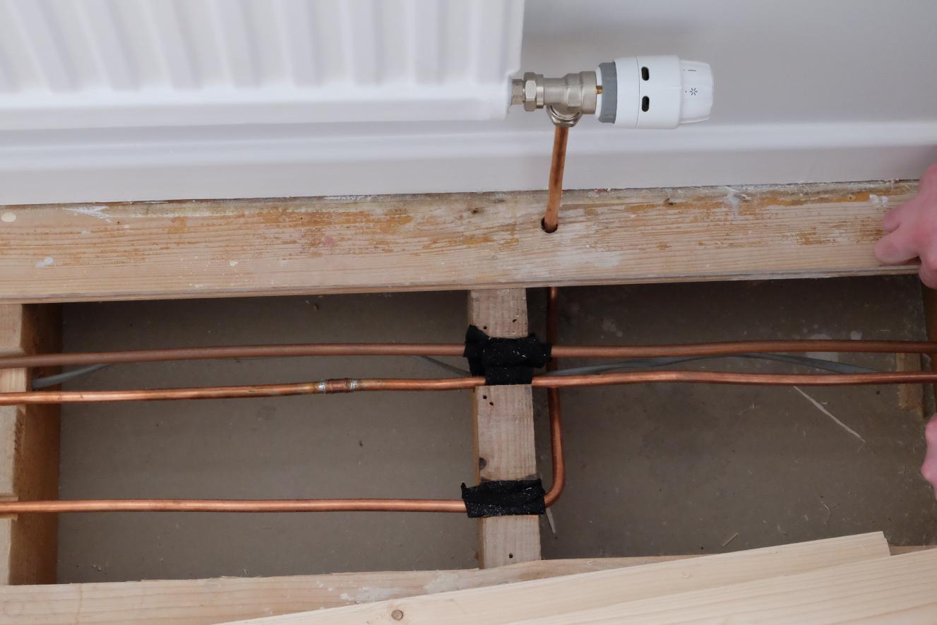

looking at picture 2 , it looks like the notchs for the 10mm pipes have been made a lot bigger recently as the woods fresh?
As I said on previous post, - the ballofix valves, or any valves have no reason to be fitted.
The OP has said the guy bunged the system and had to use ballofix valves. He didn't, - all he needed to use was 2 stopends to allow the rest of new pipe work to be done. And it is so handy with 10mm very flexible copper pipes! It's DIY and no better
As above all's it needed was two stop ends on the pipes where the 15mm SPF tees are, cut out the old pipe work and them two tee's with the bashed over ends and make new connections then quick swap from blanks to SPF fitting and 10mm could of been ran allt he way from the tees instead of butchering the joists, i'd say the installer didn't really think it through
Hi, just thought I'd update you on what happened with all this. I phoned the plumber and told him I wasn't happy, explained about the joist etc and that I would withhold a portion of the invoice fee. He didn't even question this, which I suppose says a lot.
In the end the damaged part of the joist was cut out to allow a new block of wood to be fitted in with a pre-cut notch. This was glued and screwed to the joist with a tight fit. The pipes were re-done and lagged where they came into contact with wood.

Thanks for keeping us updated, its good to know how these things turn out,
Glad to see you got a good outcome and a much better job by the looks of it
Apart from the knee pulled bend on the 15mm and a compression joint under the floor...
Blimey, so cute and even longer chunk of joist out at the same depth as previously ions one and stuck a bit of timber in. Good job it is close to the wall supporting it and not the the middle of the room. Looks neat though
If it was me i'd of just doubled up and bolted together, would of been easier aswell
We overlay the weak spot with a fresh timber with as much overlap as possible and get steel plates cut at the local foundry and bolt through from either side.
Can't just do a cosmetic repair like this joker has done as it's it's still as weak as a vegan on a diet
