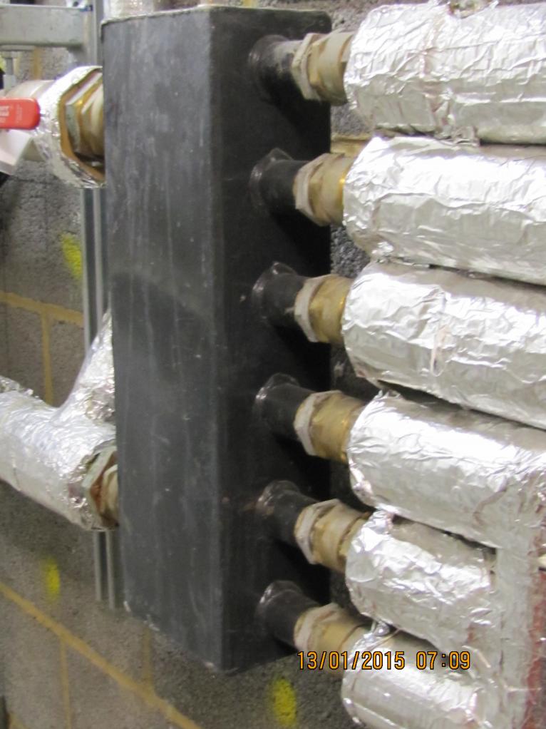

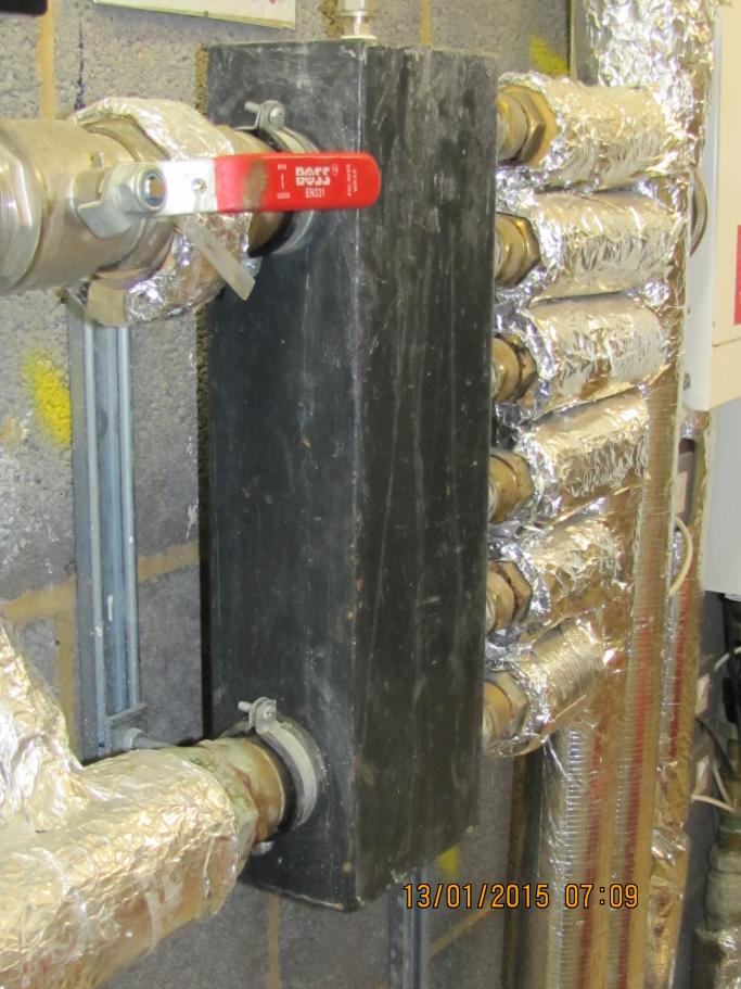

I am writing an expert report on a heating system in a care home and am unable to identify the manufacturer of the low loss header currently installed in the primary heating circuit.
I have attached two photographs of the header showing the primary and secondary connections.
I believe the header has an internal mesh screen dividing the primary side from the secondary side.
I would appreciate it if someone can identify who makes such a unit.

it looks like something that has been made for that particular job. There shouldnt be anything "seperating" the primary and secondary circuits. Is there nothing in the O&M manuals at the nursing home from the installers.

That looks like a custom made header. There won't be any mesh or separation inside.

It is custom made. The majority are.
No LLH manufacturer would put a mesh in them things. And I've certainly never seen one.
I'm guessing it's been made by a fab shop, but they usually use 4" pipe as opposed to box section, the only box section ones I've seen have been provided by a manufacturer, doesn't mean this was though. I don't recall seeing the flow and return so close either, usually some space in between

Like you I have never seen a low loss header with connections so close. Also, the only time I have seen a low loss header with so many connections is one where the boiler primary circuit had just two connections (flow & return) whereas the secondary side had 6 connections (3 - flow & 3 - return) serving one constant temp circuit, one serving a variable temp circuit and the third serving DHS primaries.
My reason for trying to identify the manufacturer is partially to obtain information about it for the O&M manual as well as assessing whether it is suitable for the system as currently installed, particularly bearing in mind the close proximity of the flow and return connections.

Mikrofill use box section on their lowloss headers. And look similar to that but all the ones I've seen are 1 in 2 out. I've also used a worcester one that was similar

There is no way that will work so would think it would have been made to order. No drain cock or means of flushing it by the looks of it, you would even struggle just removing the whole thing to clean it. Why have they used a hex galv nipple and then used a female copper to iron? Maybe thats how you remove it by running a recip saw down the threads of the hex nipples lol. Do them 3 circuits feed u/f by any chance?
No mesh unless it's supposed to chase air up... But if they were that clever it would be three times as long only have two connections either side and have a doc.
