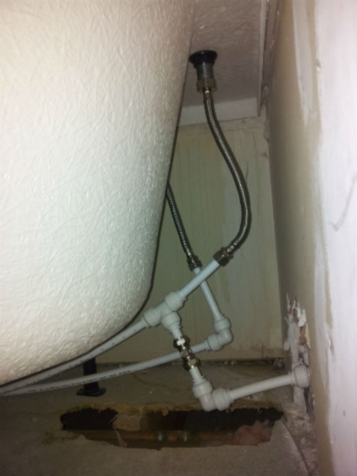

HI simon G - I suspect it is gravity fed but im not sure tbh - from what i can see i have a hot water tank in airing cupboard, cold water tank in loft etc- its a detached 4 bed house. just a typical set up from what i gather from the information on the net. i suspect the taps arent great and it would be better to get taps that accomodate 0.2 bar min pressure etc but still its really poor and it diddnt used to be. please find the pics of what was done under the kitchen sink
Looking at the pics, you have 22mm stopcock ! can't see what if anything has been done to it, you may find the problem with your water flow is the check valve just above it, either partly block'd with dirt or not opening fully, would be a simple job to replace both, Around £20/£30 for parts £45 labour ! £300.00 for what look' s like nothing has been done ! except you is taking the mick Ask for your money back.
Looking at the pics, you have 22mm stopcock ! can't see what if anything has been done to it, you may find the problem with your water flow is the check valve just above it, either partly block'd with dirt or not opening fully, would be a simple job to replace both, Around £20/£30 for parts £45 labour ! £300.00 for what look' s like nothing has been done ! except you is taking the P*** Ask for your money back.

The blue thing is your water main ! Looking at the pics the stopcock do's-not look like it has been taken apart even the marks around the packing gland dont seam to have been touched, I think you have been conn'd ! i mean £300.00 for a washer.!!
Sorry just read your reply again , if thats a new stopcock I will give up Plumbing ! Unless you can buy them with that used look so that it blends in with the older plumbing !!

The blue thing is an mdpe (blue plastic pipe) to copper straight. And you have been royally raped. In front of a paying audience!

this is what has been done under my tub - look ok to you? me is thinking maybe not .....
me thinks this sort of set up would seriously restrict flow to the shower outlet - is there not a better sort of Y connector to split off to the shower and taps or am I thinking this the wrong way?
that pipework is very poorly fitted, the isolator will reduce flow to the shower as its not a full bore. your bath supplys should have isolators also and the flexis will also reduce flow rates and your bath should be fitting on some timber braces to stop it going through your chipboard floor.

how should this be done and with parts - ill do it myself - if you have links to parts that would be useful - I am quite handy with most things and rather do it myself now.
ps, he is also the person who tore out three massive holes in my chipboard like the one u see in my picture - i suspect he done this to see where the pipes were going..... *rubbing head* at the madness
first thing to do is wined the legs up on the bath and put some timber under them to support the bath on the weak floor.
slide some 4x2 if possible under the front legs and the back legs (so 2 bits of wood, 1 under the front legs, 1 under the back legs)
The pipes are undersized off gravity you should have 22mm pipes going to the bath.
And also looking from the pipework chances are you have an AIRLOCK in it ( I did keep saying it earlier just to point out)
