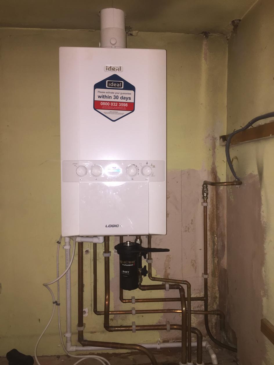

Don't know if this will show up but this is the installation in question, taken on the last day of the project. There is room to get the Magnaclean out of the top before anyone says 🙂
I was pretty pleased with it tbh for my first one.
PS Don't blame me for the existing shower cable on the right hand side of the picture, no part to play in that!!
Wish I got some photos of the vertical flue in the loft. Don't know why I didn't! All clipped in with the proper clips and looking dappa!

all looks good to me,
did you seal the flue going through the ceiling?
did you screw the flue to the spigot on the boiler? as cant see any in the pic,
and that wiring is a mess why didnt you shorten and use proper flex clips instead of t+e
wheres the fcu for the boiler as well?
wheres the main lever/full bore valve to turn the mains off to the boiler
where does the prv and cond terminate as not in pic?

I assume croft would have done everything to regs and the ins man and this photo was taken before the job was actually finished
Looks like a small shelf/ledge under the boiler, thats where I would have put the spur
Also, Ideal have a vert flue adaptor which is held in place with a screwed clamp and from memory, doesn't need a self tapper through the joint into the air duct
I never put a full bore/lever valve before a boiler isolation valve on my installs either, can't see the point

fair enough on the lever valve, but thinking what gas safe would look at
No small shelf/ledge underneath, the floorboards were up when this photo was taken. It's the old airing cupboard for the hot water cylinder that was heated from their solid fuel back boiler.
The flue is clamped onto the top of the boiler with a special bracket that Ideal supply, it doesn't get screwed in other than at the clamp. Followed the instructions for the flue and gas installation to the letter.
There is a main lever valve built in underneath the boiler to turn on/off the incoming mains for servicing.
FCU for the boiler is on the right hand wall just out of sight. It was an old airing cupboard and I have reused the wiring for the immersion heater circuit.
PRV runs outside and is fitted with the manufacturers fitting on the end to direct any flow back onto the wall.
Condensate runs directly into the internal soil stack under the floorboards.
Vertical flue is properly clipped in the loft space, 2 clips for a 1.5m run.
Photo was taken prior to the job being completed, wiring has been tidied up and clipped with correct clips on the finished install, I forgot to take pictures of the boiler/flue at the end though. I wanted it out of the way whilst I was soldering the pipework under the floor of the airing cupboard and I only had T&E clips on me at the time. No biggy really though and doesn't affect the gas safety. The Gas Safe letter says they only get involved if there are gas safety issues and there aren't any, of that I am 100% certain.

I cant see ceiling fire stopping there as per the building regs part B sec 7

Nope just pointing a potential issue out if he was to get inspected.
Last thing he needs is a defect on his 1st install while on probation.
To be honest with you I didn't put a fire stop in. I've never seen a single boiler fitted in all my time in Lincoln that has one or that is sealed. I guess it depends on the inspector. If he looks over the whole installation by the book he is going to find fault in my work. Is it safe though? I would certainly argue that it is. At the end of the day it's all very academic - if they find faults and he doesn't let me back in to fix them that's the end of it!
It doesnt make it right tho..
But I wouldnt presume all inspectors are gonna be so understanding on balance some will be fine and others could be a pain.
The best way is to install by the book from day 1.
I have lost count of how many i see without earthing near the meter outlet or incorrect condensate or leccy wires trailing gas pipes - but i don't think ill do the same and nor should others.
The regs clearly state should be firestopped but that doesnt look sealed anyway. but i dont want to upset anyone so ill shut up and keep my opinion to myself
