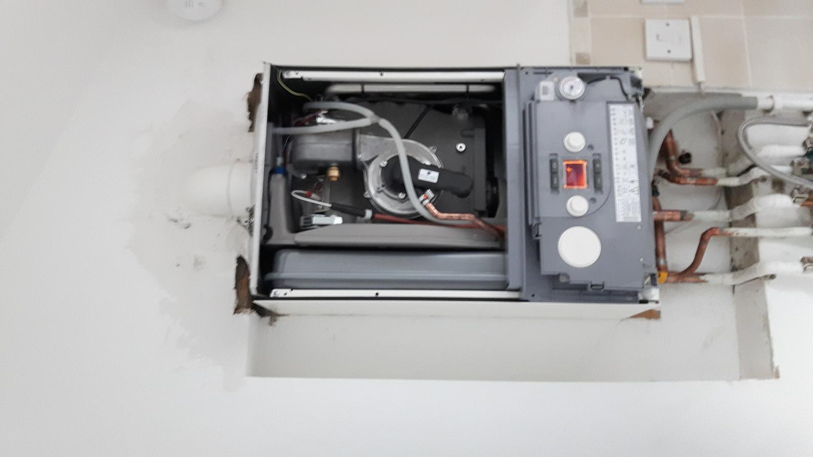

pictures shows a boiler situated in a recess left by a window which has been bricked up. the boiler is too large for the recess so the engineer has allowed the top overhang to come right over the boiler, he's then sealed the flue in

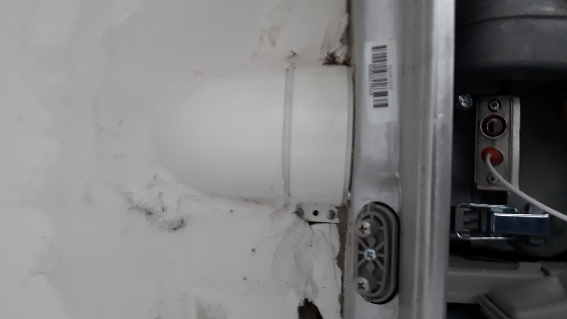

no way of telling if he's filled the hole all the way down the flue or if there is a cavity between the bricks, buts its sealed on both sides of the wall
there is no way of accessing or checking the joint on the back of the elbow
if it leaks as its sealed on both sides there's no where for flue gasses to go.
on the other hand there is no way you'd put a compression joint on a gas pipe inside a wall and this is similar
had a look in the books and on room sealed flues it doesnt say within a wall it has to be a continuous length. however it just doesnt feel right
I'd tell them that the internal skin needs to be cut away to inspect the flue joint for corrosion etc
Then they could make good the inside skin with an arch or whatever as the lintel is abviopusly damaged or removed
As for a classification, same as flue in void without inspection hatches would be my shout
brand new boiler, i was just there doing a cp12 as theyre selling flat
I dont think we can call it a flue in a void as its not a void, its a masonry wall
certainly an odd situation

not sure that clears it up and i havent found anything which definitively settles it. But i do seem to be going against the tide here.
at the time i thought 'wheres it going to leak to' and didnt AR it. Soon as i left however started to doubt myself
more risk of the wall collapsing than the flue leaking, till the wall collapses. I would check air inlet for co/co2 and if clear leave it alone.
