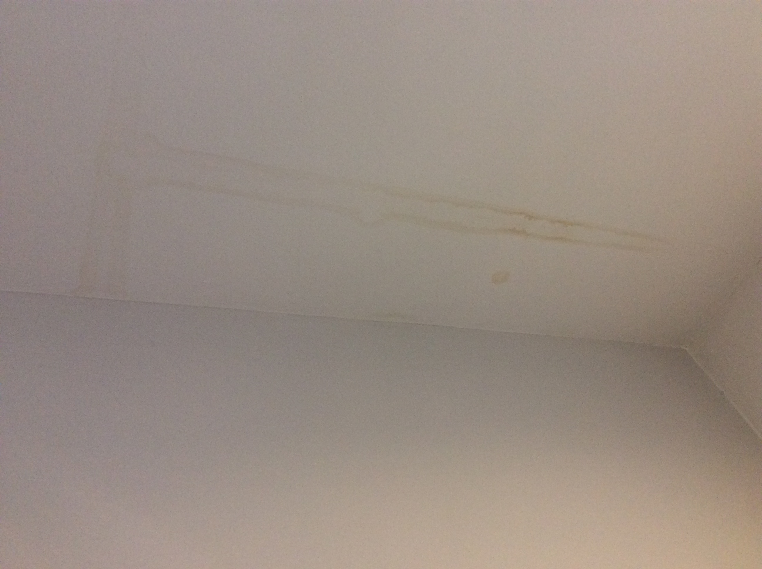

Can somebody please help me with a problem I have. This has appeared recently on the ceiling and under my bathroom, which is built into the loft space. There is a corner shower which we think may be leaking but then surely it would be a pooling effect instead of straight lines??
Does anyone have any idea what it might be?
Its definitely a water stain. You'll have a joint in the plasterboard there so as the water gets into it, it tracks down the joint forming the staining you see in your photo.

You will need to gain access under the shower if it is not leaking at the valve or associated pipework. When you can see underneath the tray, have a look at the pipework and see if there is water on any of it or running down any pipes. Run the shower and take a look. Be sure to spray the shower over any walls within the enclosure with water and take a look underneath. If it isn't pipework feeding the shower leaking, it might be the waste pipe so again, inspect after water has been put through it. It could be the seal around the tray or through the grout or panels or whatever method was used to make the enclosure.
Post some pictures of the area if you are struggling to uncover pipework or gain access.

Is the stain wet and or growing? Or is it a one off from an exuberant showerer?
If it is ongoing, you need to get to the root of the problem / source and that is unlikely to be a quick / easy fix.
Whatever, don’t leave it, unless it is the former ( a one off) the situation will deteriorate rapidly. If in doubt ( and if possible) restrict use if the shower until the problem is resolved.
With respect to the ceiling. Once plaster / gypsum based plaster board has been soaked it should be replaced - it never properly recovers, even after drying out, it always retains the affinity to attract water.
