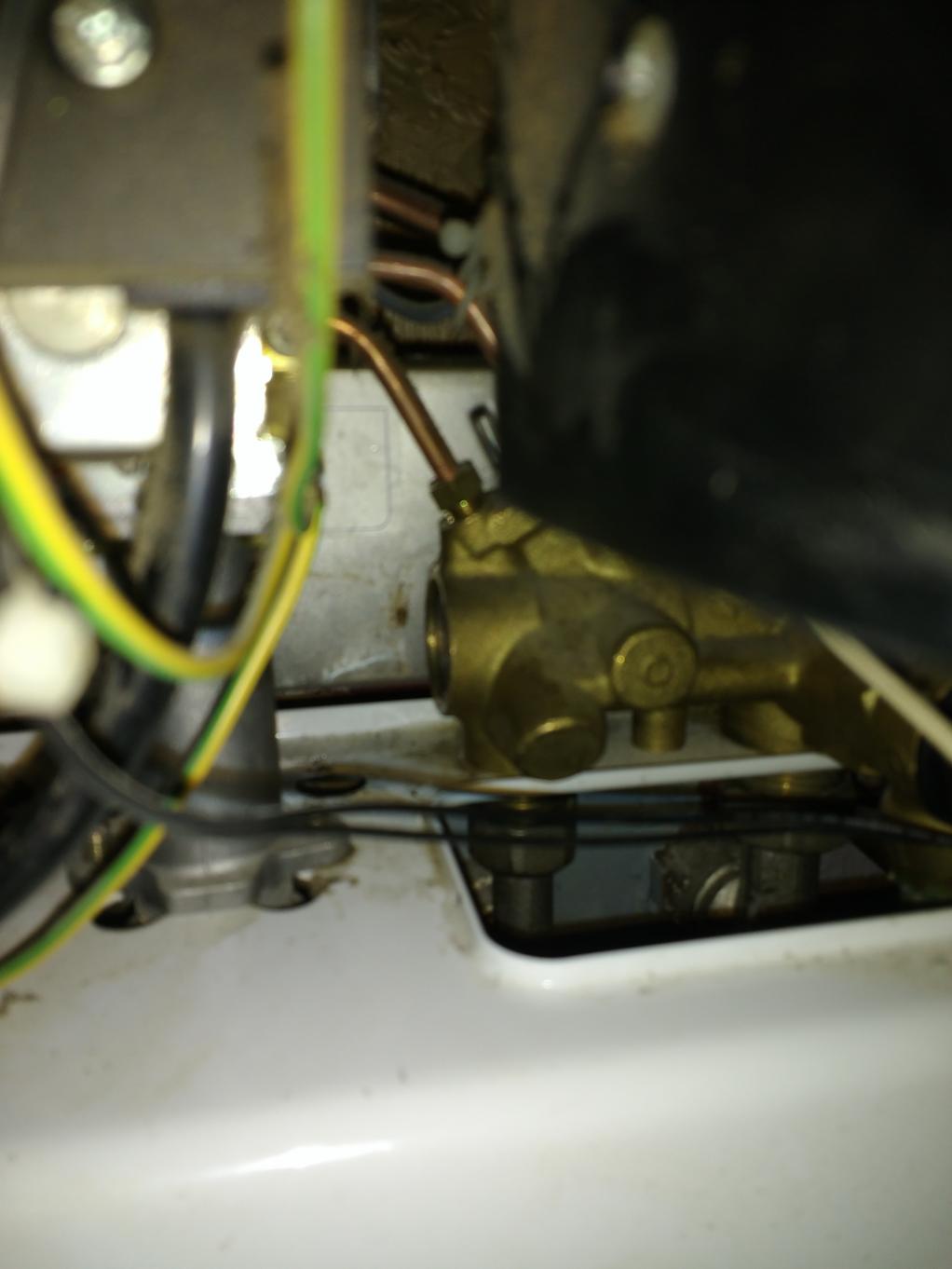

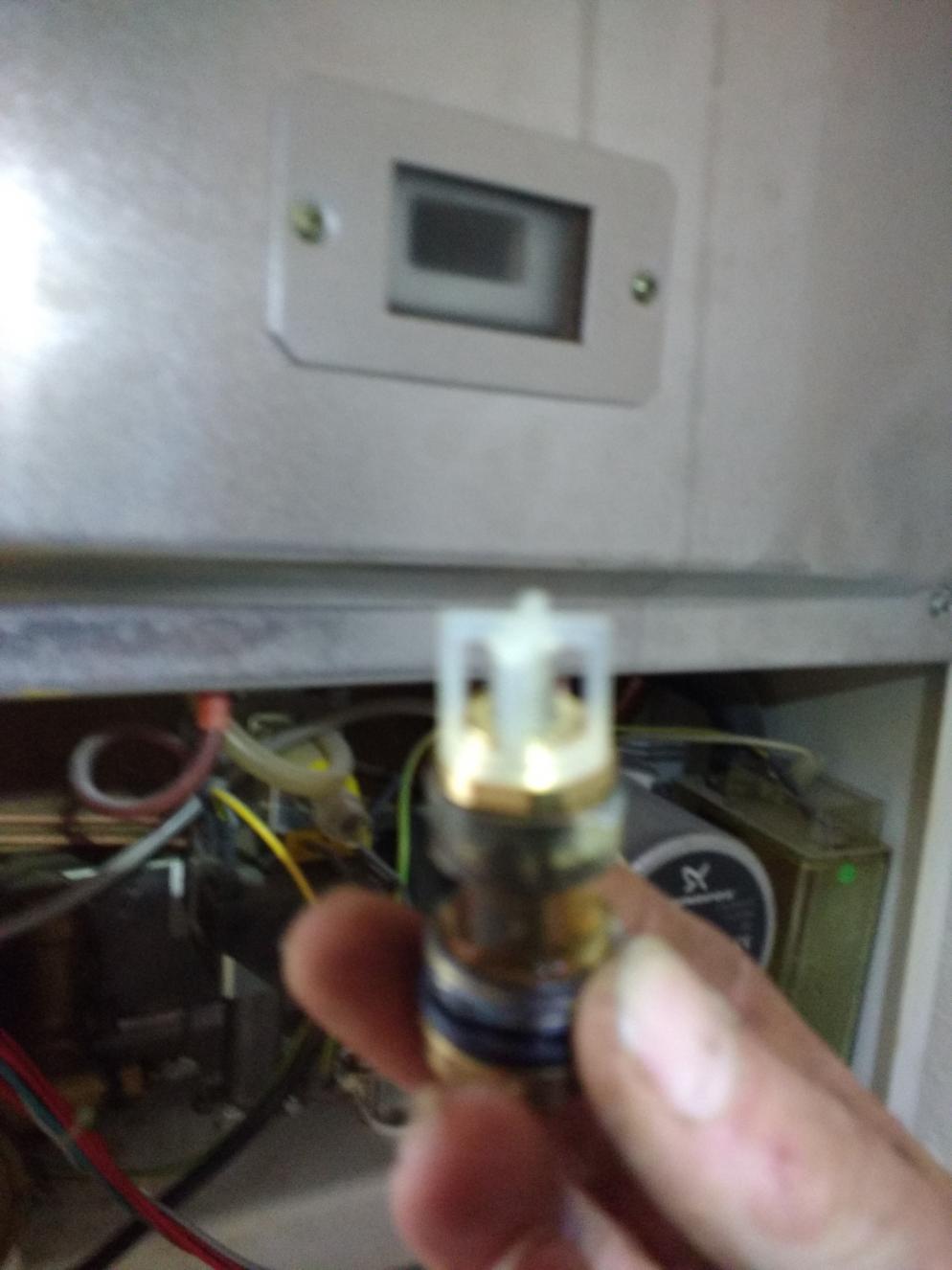

one i recently did to give you a idea IMG_20160201_151014488[1].jpgIMG_20160201_150957293[1].jpg
Fantastic, thanks gas man. That's the part, I found the cross end bit and spring by return port at plate HEX.
Local merchants told me it only came as part of the whole block!
I'm just hoping that changing this will sort out the slow movement of dhw pressure diff valve?
Thanks again to gas man for venturi part number.
Dhw diff pin was seized on the rear exit. Which I should have bloomin cleaned and greased when doing the diaphragm.
