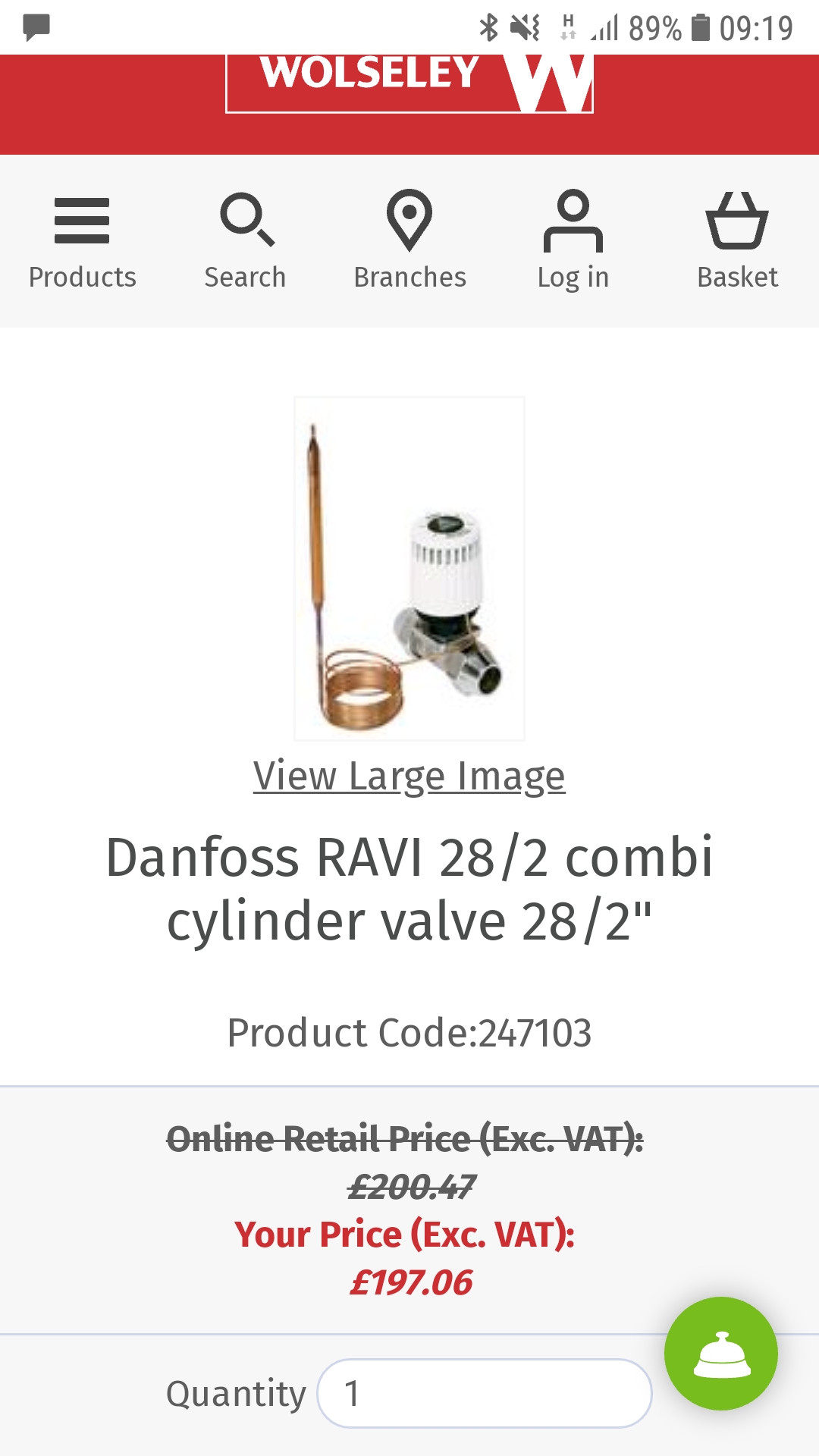

One of these maybe an idea for gravity just make sure there's a heat sink rad

Danfoss | 540188 | White
I have used this thermostat a couple of times obviously wired is better but it does do the job and seems pretty accurate
That's the one I was looking at. Will now just have to see where the feed and vent go as i dont really want to pressurise a 30 year old system in a b&b when it's coming up summer.
Hello Steve weightman,
The Danfoss Hot Water Cylinder Thermostatic Valve might be a good suggestion for the OP`s requirements if as He mentions there is an additional `Heat Sink` Radiator and the Feed & Vent pipework on the system will allow or could be altered to suit fitting it.
But - what a price for something that is not much more complicated or expensive to manufacture than a 22mm TRV with a remote sensor probe !
That is an example of a product where the fact that it negates the requirement for a Hot Water Cylinder Zone Valve and the associated Electrical wiring / Electrical thermostat allows the price to be vastly inflated well over the cost of manufacture / manufacturers profit and suppliers overheads / profit.
I know that the Danfoss valve can be bought for less money but still usually way over £120.00.
Obviously in situations such as the OP describes these prices might still be actually be cost effective / easily justifiable compared to other alternatives.
Having written that - a RF Cylinder Thermostat can cost quite a lot more than that and would still require that a Zone Valve was installed for the Cylinder which would have to be wired up - but possibly close to the Boiler ?
