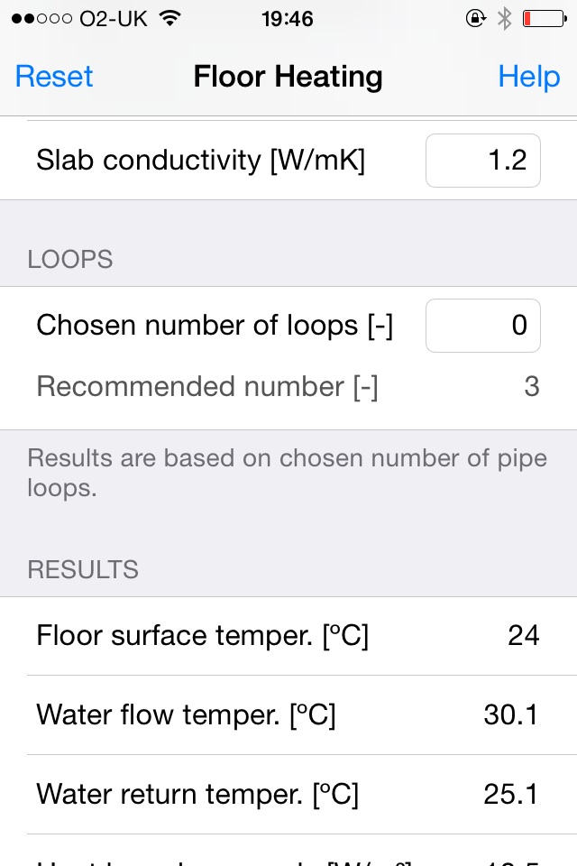

Just done a quick dork out o. My ufh app.
Recommends 3 loops, with a total length of 205m at an average of 159mm centres.
you will need massive water velocity to get any heat.
balls up by installer, the stupid thing is that splitting it up into 3 loops uses no more pipe.
