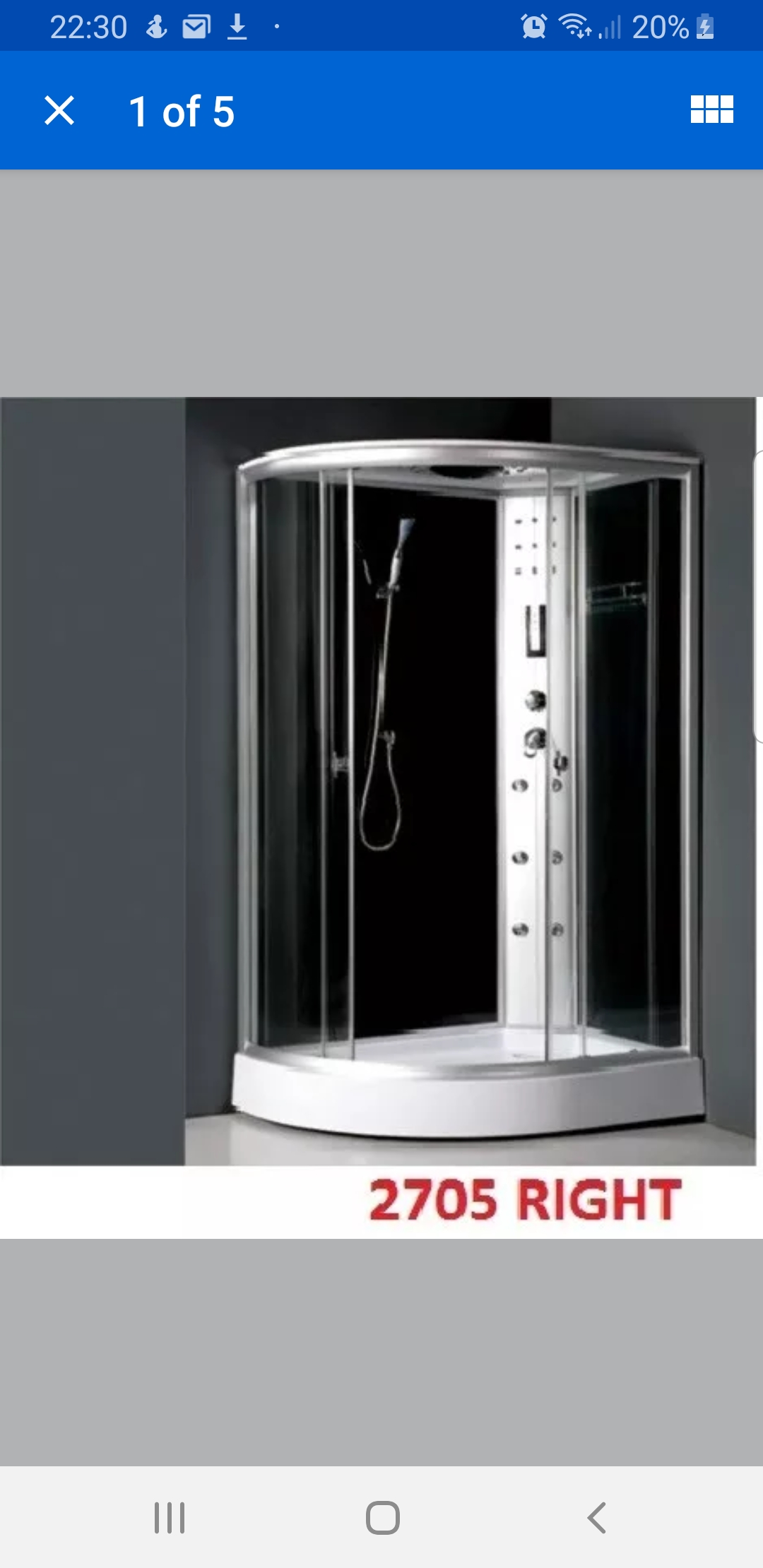

hi the boiler is a combi Worcester Bosh 28i junior
will do the test on the water when I get home...just wondered what heads release more water....this is the shower

Have you tried cleaning the filters on your shower?
no as we have only had it a week so didnt think anything would need cleaning

just bought a new shower head (non eco) and wider shower hose and it seems to have done the trick...so fingers crossed....thanks for your help though
