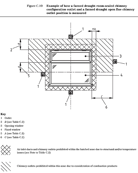

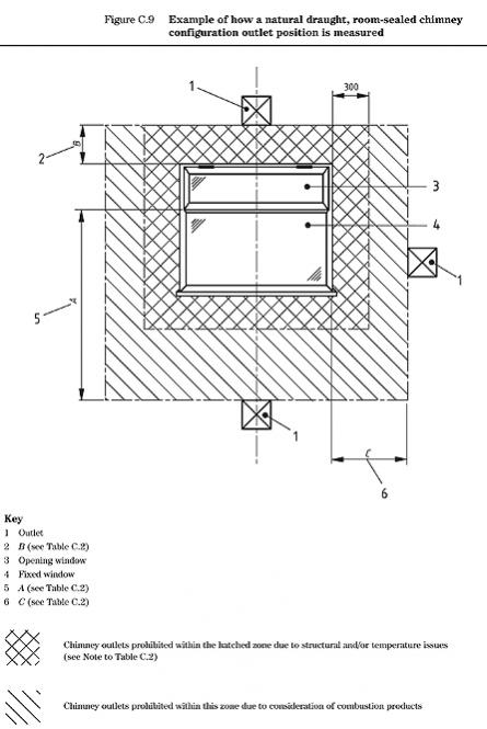

I was taught it was from the edge of the inner flue to the nearest point of the openable door or window (or vent) that products can enter the property (ie the window section not the frame).
Here it is:
From current BS 5440 Part 1:2008
Flueing and ventilation for gas appliances of rated input not exceeding 70 kW net (1st, 2nd and 3rd family gases). Specification for installation of gas appliances to chimneys and for maintenance of chimneys.
