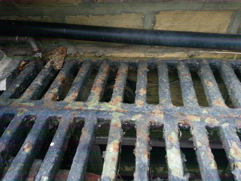

seen a cross threaded thermocouple bulked out with ptfe at the gasvalve end today i kid you not
[/quote]must have missed the section on curtain wire and duct tape being acceptable fixing methods

first time putting pictures up. didnt quite get that right! love the way the curtain wire is tied around a velux window handle.
builders job refurbing whole house. know the plumber who started the job but walked away refusing to install boiler the way they wanted. never found out who finished job, just got job of putting it right!
