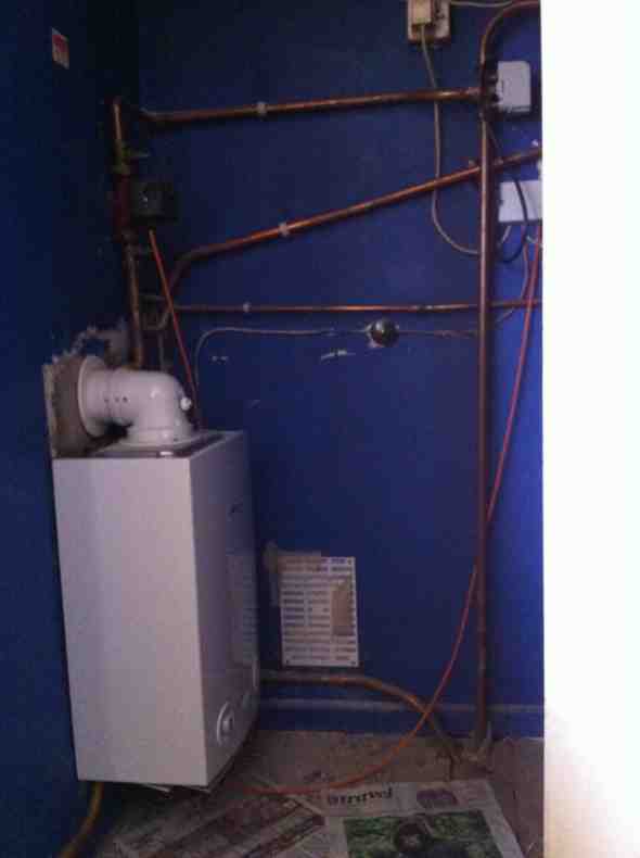

Does someone spot a problem with this 30kW Boiler? As a hint: 6-8mbar working pressure :cowboy: (my personal new record). According to the commissioning sheet there were last year at installation time 18mbar measured. Customer had to help me back up after a glance at the commissioning sheet. This installer could definitely go as a comedian.And he told the customer that this boiler is definitely capable to be run off a 15mm gas pipe (estimated 10-12m + minimum 9 fittings excl. straights).
Sorry its on its side bloody ipad. Installed by Eaga on a grant, customer claims it has never frozen :crazy:
I think the soldiering & electrics tell the story Dirk !
