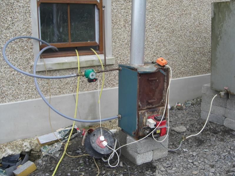

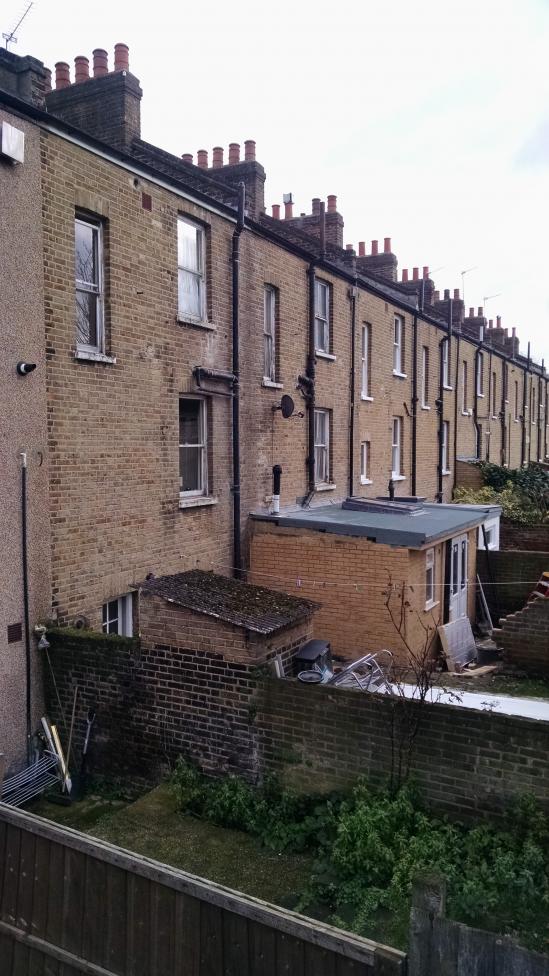

For anyone who doesnt know the OFTEC regs, tanks should be at least 1.8metres away from a non fire rated building or structure (eg shed)......
This is going off to the OFTEC magazine, see if I can be the most published this year lol
more of a worry to me is the tank stressing by sitting one corner on a brick, oil all over idc
