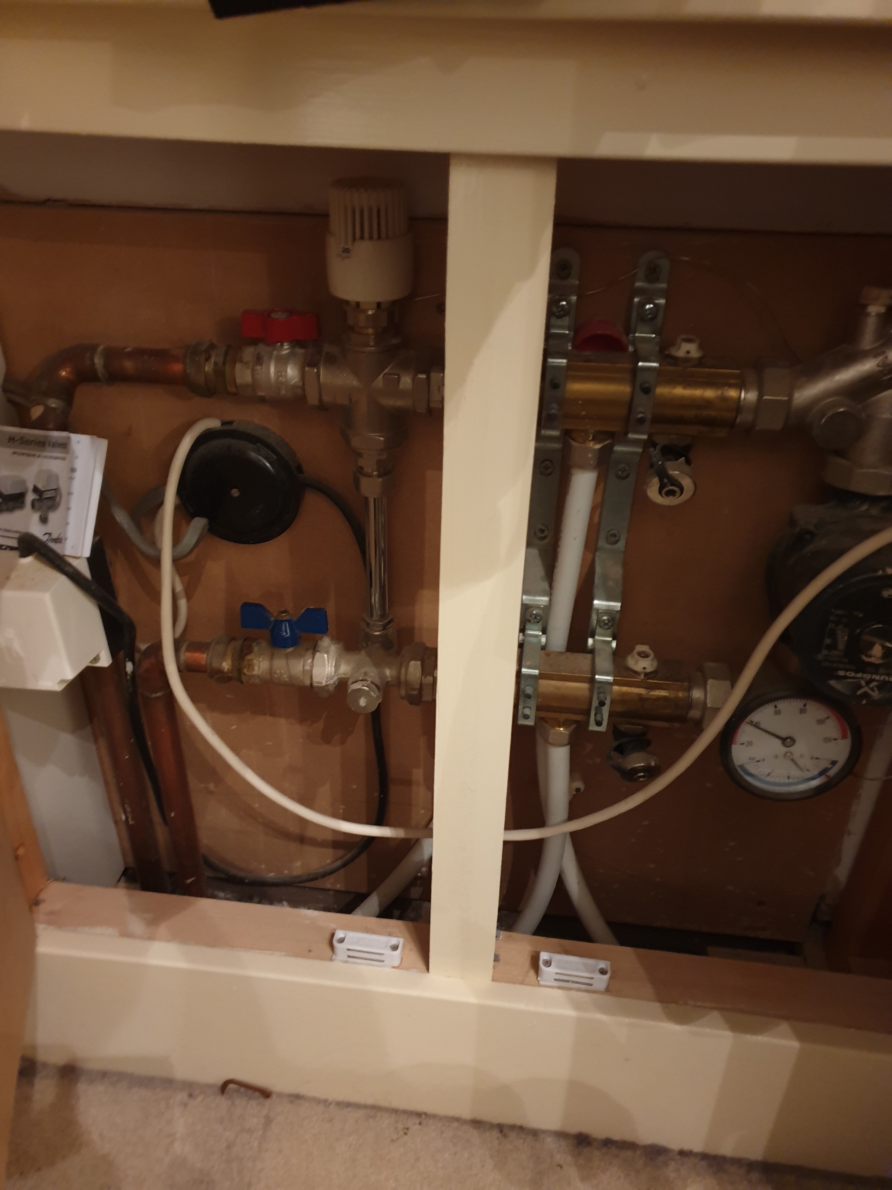

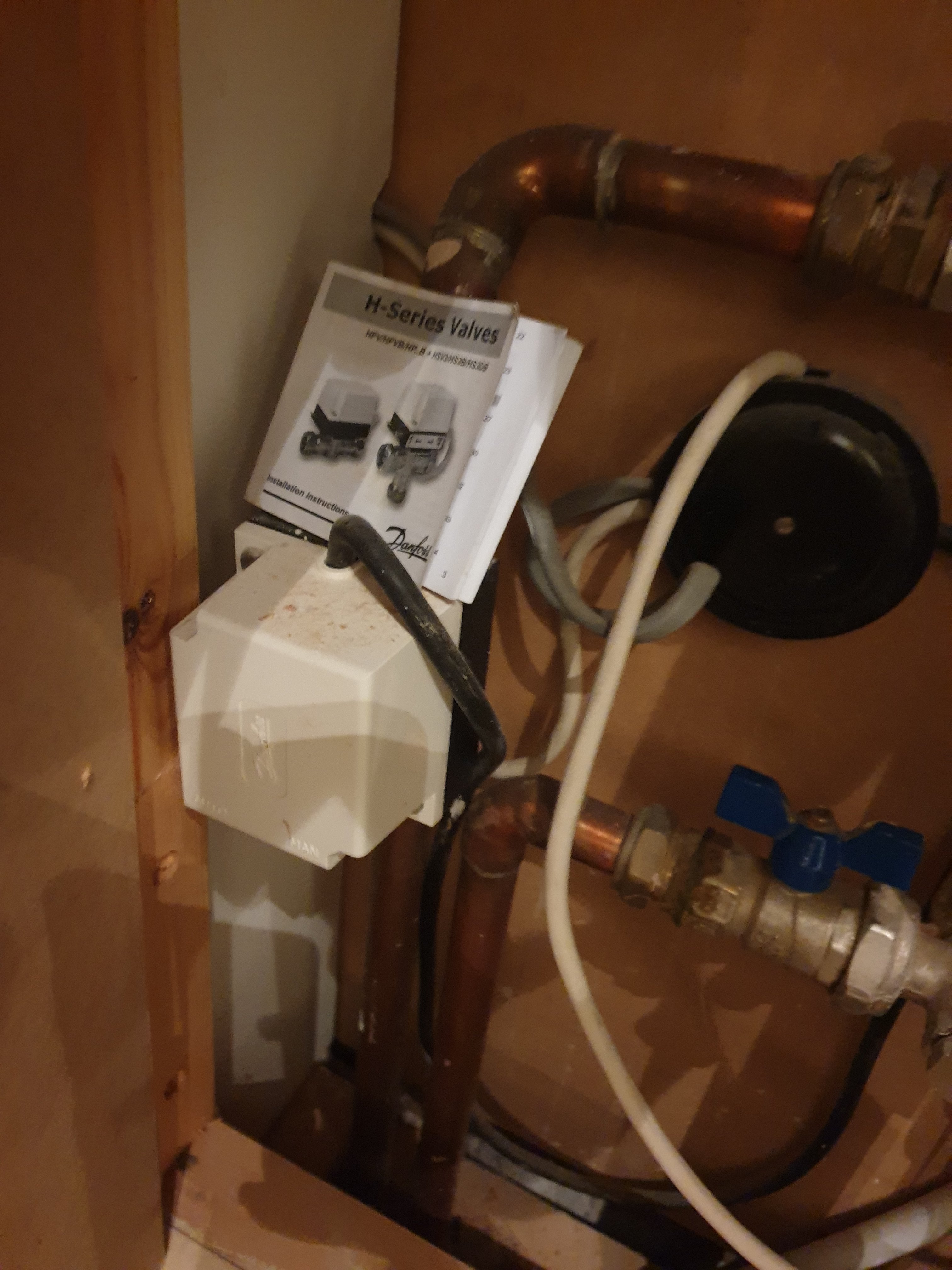

Thanks for the reply. I attach some images.

Thanks for your reply. Sorry not sure of brand. I attach some photos.

If you want to guarantee the floor will no longer heat until a plumber takes a look at the problem, you can close the red handled valve on the manifold which will stop the circulation and keep your flooring cool until it gets fixed. This will not affect the rest of your heating system.
I would say the mixing valve is at fault but you will need a heating engineer to attend and diagnose it properly but as above turn off the red handled valve until he can get there . Cheers kop
