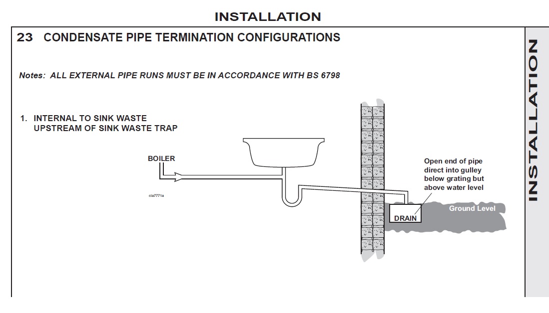

If you don't leave an air gap asper mi then theres no warranty if the condensate backs up and damages the boiler (on a cold day)
I already posted an extract from the BS in post 31 with the relevant diagrams.
Since you are familiar with Logic's if you read page 23 of the MI's you will find this
and read page 7 and it says this as do almost every other MI out there

Logic doesn't show tundish or open cond pipe? Ahhhhh but it does show cond above water trap! Devil is in the detail!!!

Been to isar ruined as down pipe was blocked, roof tried to empty via burner in boiler, 3 visits later new boiler as it was dry when visited looked at water damage on fan and it twigged! Don't use rwp! Without air gap .

I got to page 6 and got extremely bored, so skipped to this page. So you had Alan Matthews round, correct in what he said. You should not discharge into rainwater or land course without neutralising the condensate. Further to this, if the rainwater became blocked and or backed up due to heavy rain this would cause problems with the boiler unless there is an air break in the pipework. Tamz is spot an as usual with this thread.
