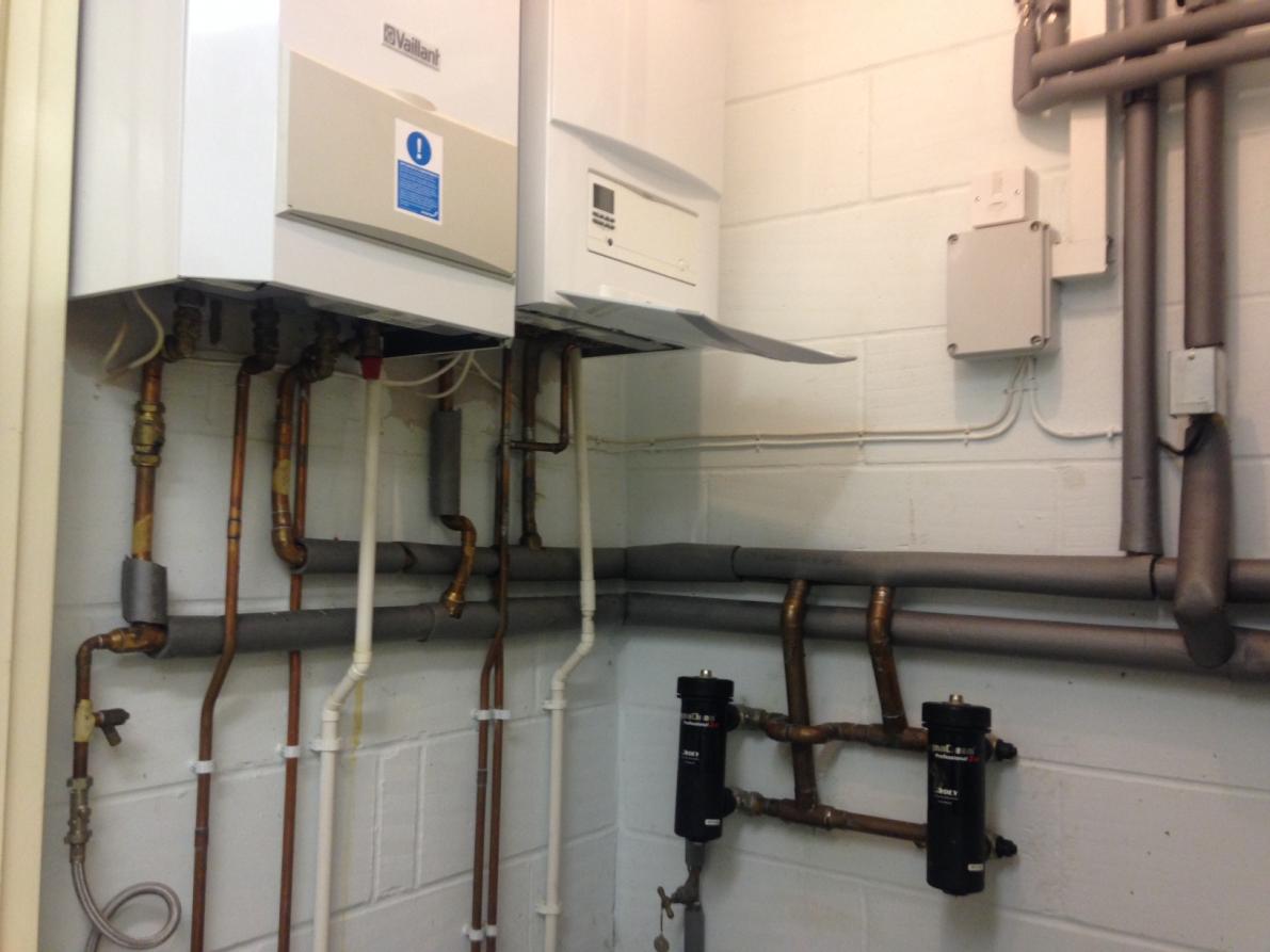

Here is a photo of the current install.
- I would need to move the Magnetic filters over to the Right and have the LLH fitted between the left wall corner and the Adey Filters. Unfortunately the Return is currently located above the Hot Feed, so I would need to juggle the routing in to the LLH :38:
- The new circulation pump to draw Hot Feed from the LLH would need to go in flow by the CH Zone Valve on the right hand side of the Rear wall in the photo.

I presume that they are elbows not tee's on the return pipework underneath that lagging where the magnacleans are, and that the lagging is the only thing bridging the return pipework where the magnacleans are?
Yes, it does look a little odd, but yes they are elbows.
This was the original design, but It ended up being implemented below the pipework rather than above. And of course it was 35mm tube going down to 28mm to each Magnaclean XP.
This looks like someone has been trying to cut costs all along... (or ignoring the original advice given)
Any heating engineer worth their salt would have recommended the LLH when the boiler replacement was done.
It should also have been configured as reverse return / Tichlemann --- plumbers, fitters vs Heating Engineers 🙂
