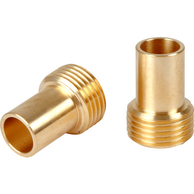

i would ptfe tape any olive fitted to a bit of copper tail, they are soft copper and prone to leaks with compression.
fit these into the top of your isolation valves from toolstation
