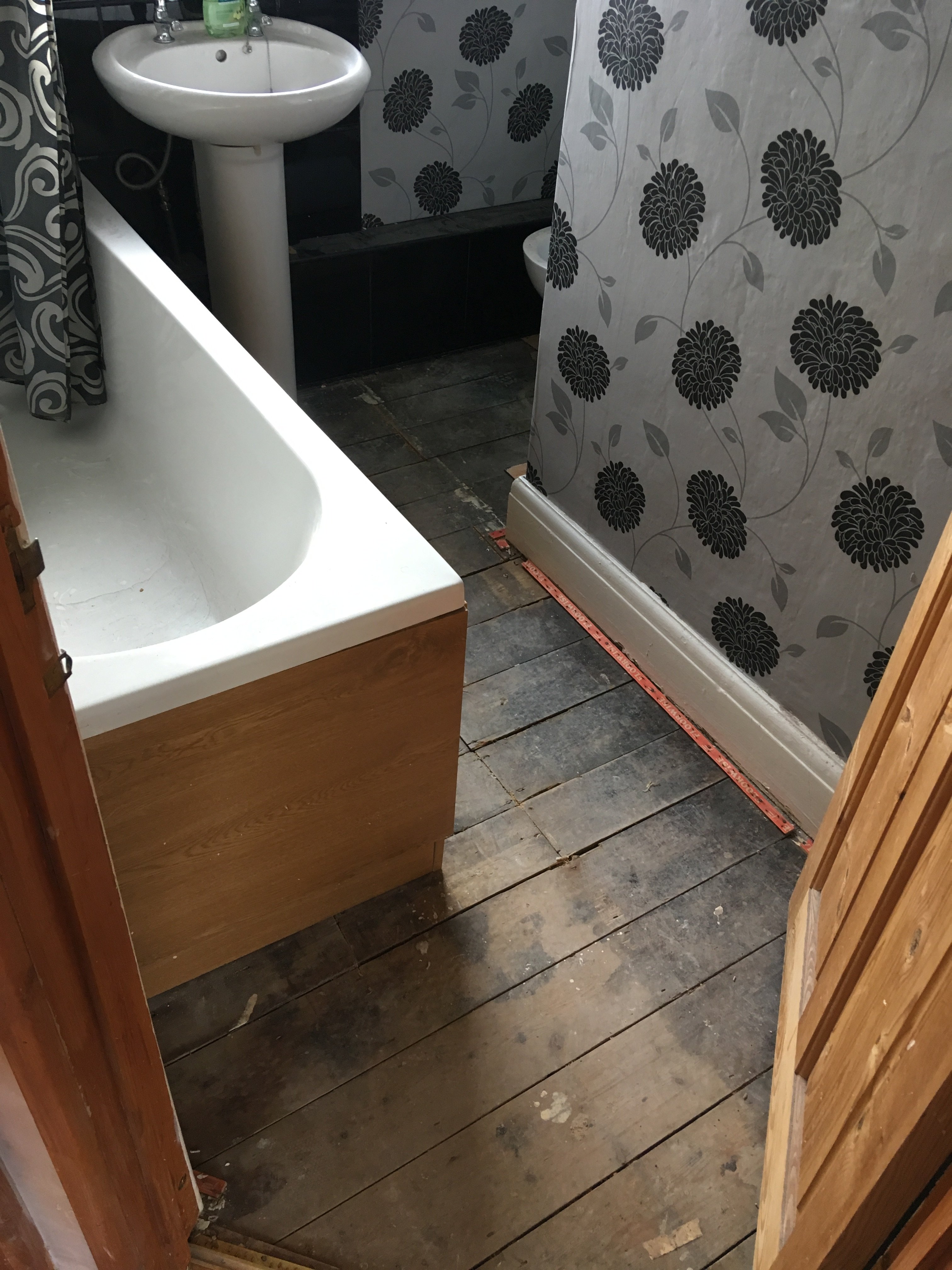

Just had a thought in relation to what Ben-gee said, what is your current set-up? Any photos? Maybe we can suggest to help you based on that?

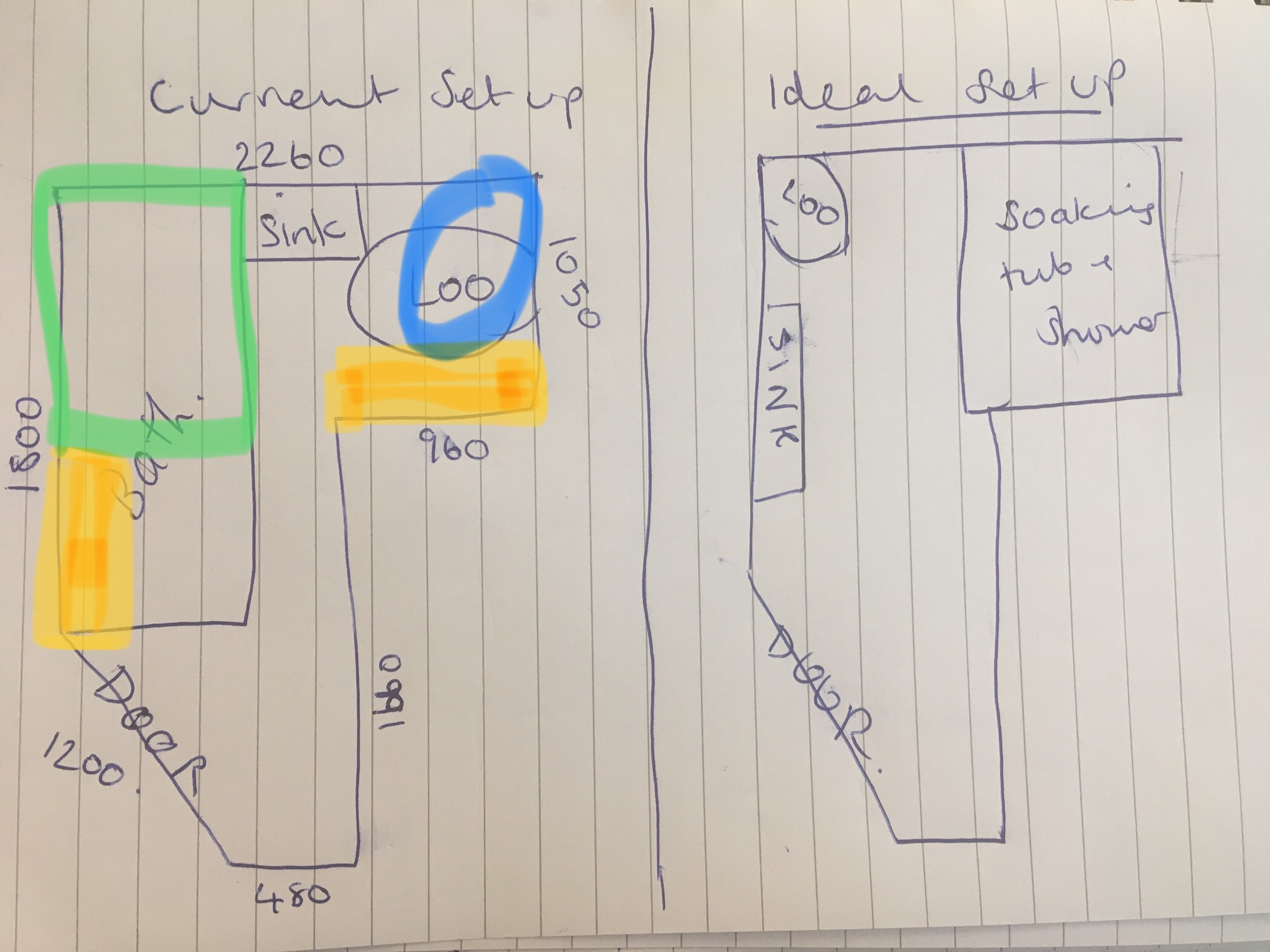

So I've had some advice from the bathroom fitter, who said that the main problem is the distance that I want to move the toilet. He said that I wouldn't get the fall on the soil pipe and that a macerator would be the best option.
I have attached a drawing (not to scale but dimensions of the room included).
I have the new bath suite, so am fairly fixed on the smaller, deeper tub and corner toilet.
Would also have to be an internal soil pipe otherwise it would run across the front of my house. Plumber said there would be room for it, the only issue is creating the fall.
I’m just inquisitive, why all the moving? Any reason why (I’ve attached amended drawing) toilet can’t go where I’ve highlighted blue, the soaking tub/shower go where green,and sink in one of the yellows?
Unfortunately, the tub is too wide to go there. It would leave me with barely a foot at the side to walk through to reach the toilet. It’s bad enough now with a 680mm wide bath. Soaking tub is 900 x 1150. Opted for a shorter, deeper bath so it could go in the alcove where the existing toilet is.
Would that boxing in have to go when new bath installed? If not, why not run soil pipe through that? I don’t see how fall is much of an issue.

Looks like joists run same way as bath, nails on photo give an indication.
Yes, the joists run in the same direction as the bath. The sink and the toilet are on the outside walls. The sink wall is the front of the house and the toilet wall is the side of the house.
There is space behind the boxing in and the pipe would fit behind the bath.
The plumber said that the only issue was creating enough fall so he asked me to find a toilet with a high outlet. When I couldn’t find one, he said I’d need to have a macerator.
So in your opinion, can I get away with having a normal toilet and running the soil pipe internally along the wall and boxing it in? It would run for about 2 1/2 metres, including around two corners, from the toilet to the soil stack. Are you saying that the fall isn’t a problem?

So is there a way of having the layout I want and having the toilet plumbed in without a macerator?
The current problem is that the new loo and the existing outlet are the same height so the plumber said it wouldn’t create any fall. He said to find a toilet with a high outlet (at least 220mm), but I couldn’t find one despite asking the local suppliers, so then he said a macerator would be my best option.
But what if a new hole is made into the soil stack, say 2 or 3 inches lower than it currently is, and running an internal soil pipe to it? That would give me a fall of 2 or 3 inches across 2.5m. Would that be possible?
It would be possible, but obviously need to repair old hole then. Your plumber has probably already done this, but have you measured the floor to centre of existing soil pipe and toilet and your new one?
Yes, both are 180mm.
It really is simple to sort.
1) raise the pan outlet height.
Or
2) lower the soil connection height.
1) is achieved by building a plinth.
In your case I would raise the whole floor from half way along the corridor part. One step should suffice , the wc and basin would be on this raised floor - it would also have the effect on making it easier to get into the bath.
2) yes this can be done, obviously we can’t see how in your case but trust me it can. That’s why I keep saying you need a decent experienced set of eyes on the job.

Thanks everyone for your help and advice. I am really grateful. I have posted a diagram of my ideal set up for my bathroom including dimensions and some details.
I have already purchased the suite so I would really like to make this layout work if at all possible.
Is it possible for the internal soil pipe to run as diagrammed in my picture (blue line)? It would be almost a 3m pipe with 3 bends. Is this possible to do without the risk of blockages?
Also, is there a standard ratio of fall that I would need to have? How would I work out how much to raise the toilet or lower the waste outlet?

In answer to your question, the fall on soil pipe should be 18mm per metre .
(ok ok it can be more, upto 80/90mm - but for these purposes use 18mm/m)

Any reason why it can't be run this way? Where the pipe exits the wall under the bath, run it as low to the floor as possible then it will have a good fall from the toilet. 1 external 90° bend towards the stack and then tee in. Or am I missing something.
Also the measurement for your bath is 1150 but the opening is 1050. Are you sure the bath will fit.
