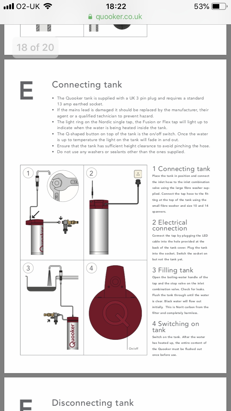

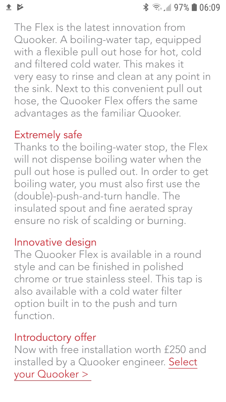

Quooker: ‘The water is heated to 110˚C in the Quooker tank…When the water flows out of the boiling-water tap, the water cools from 110˚C to 100˚C and boils.
I like the idea of water cooling to boiling point. But seriously, am I missing something or do Quooker just ignore the Building Regs? (and the Water Regs.)
So in simple terms there is the equivalent of a high pressure steam engine installed in a domestic kitchen , ok never in mine or my customers ever

FWIW, I've seen first hand some horrific burns caused by relatively small amounts of very hot (not even boiling) water, and these gadgets make me very uneasy.
