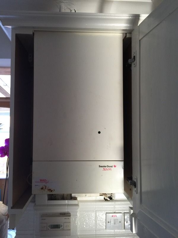

Hi guys, just had a right mare, went to a friends house today because they could smell gas and thought they had a leak in their kitchen.
Upon switching the boiler off as to not effect my tightness test I saw this and thought O no what have I walked into. Was I right to AR the boiler isolate it and tell them not to use it and advise them that they need a new boiler?
Also found leak on compression joint under gas hob. Fixed that 😉
Also would you look to relocate the boiler as I have never had to discharge a flue which passes through a conservatory before 🙁
Was an extended flue actually available for that boiler, think I would have ID'd that.
Nice job but still think it's ID
I dont think that is even the correct flue, think they have used modern flue adapted to extend the old one.
I thought ID, but AR or ID it's a friend i've isolated it so they will not be using it now. Will be back Monday to discuss best ways round putting in a new boiler.
Pretty shocking who ever has done that, I know it wasn't them as they have only just brought this house as a repo.
Poor girl was in tears when I told her the bad news. But she understood as they have young children.
Is say you were definitely doing the right thing slapping an AR on it. This is just another example of why I tell family, friends and my customers that if they ever think of moving they should get there place inspected before hand and get a gas safety cert for it.

its a saunier duval.....nuf said, cap it!!!!!!
you just said that to pick up some easy likes
My vote is ID, you cant mix and match flues, that boiler is an ugly mess
why do saunier duval always come up when someones brought a new property, i've capped one and told another customer not to bother fixing it as its past saving in the last few months. telling a customer they need a new boiler is a tough call when theyve just brought a house and have no money left
Are people moving house just to get away from a saunier duval
PS anyone reading this who has a saunier duval, sorry to inform you, but you need a new boiler, that also goes for anyone with an ideal isar or a potterton puma
