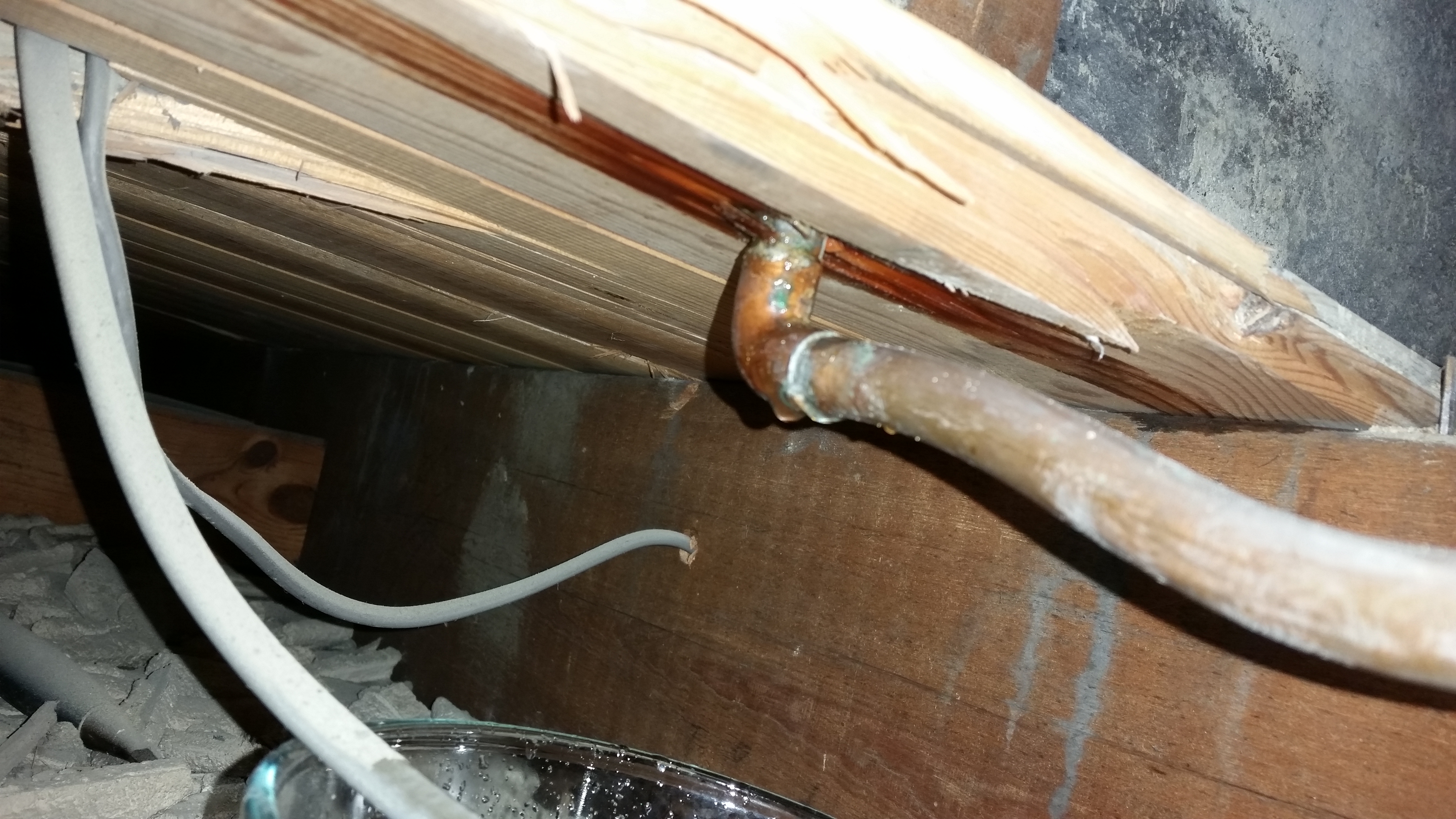

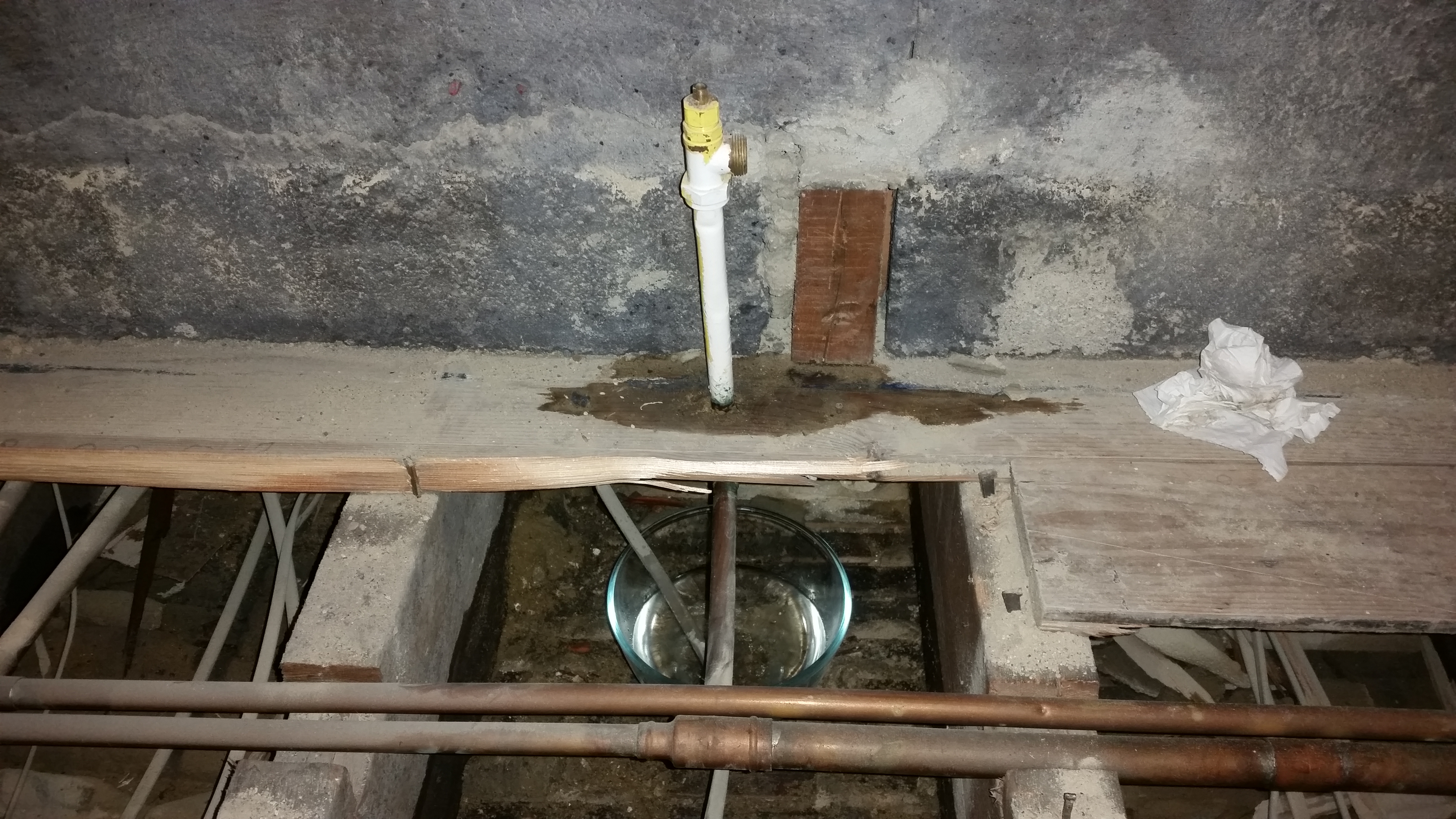

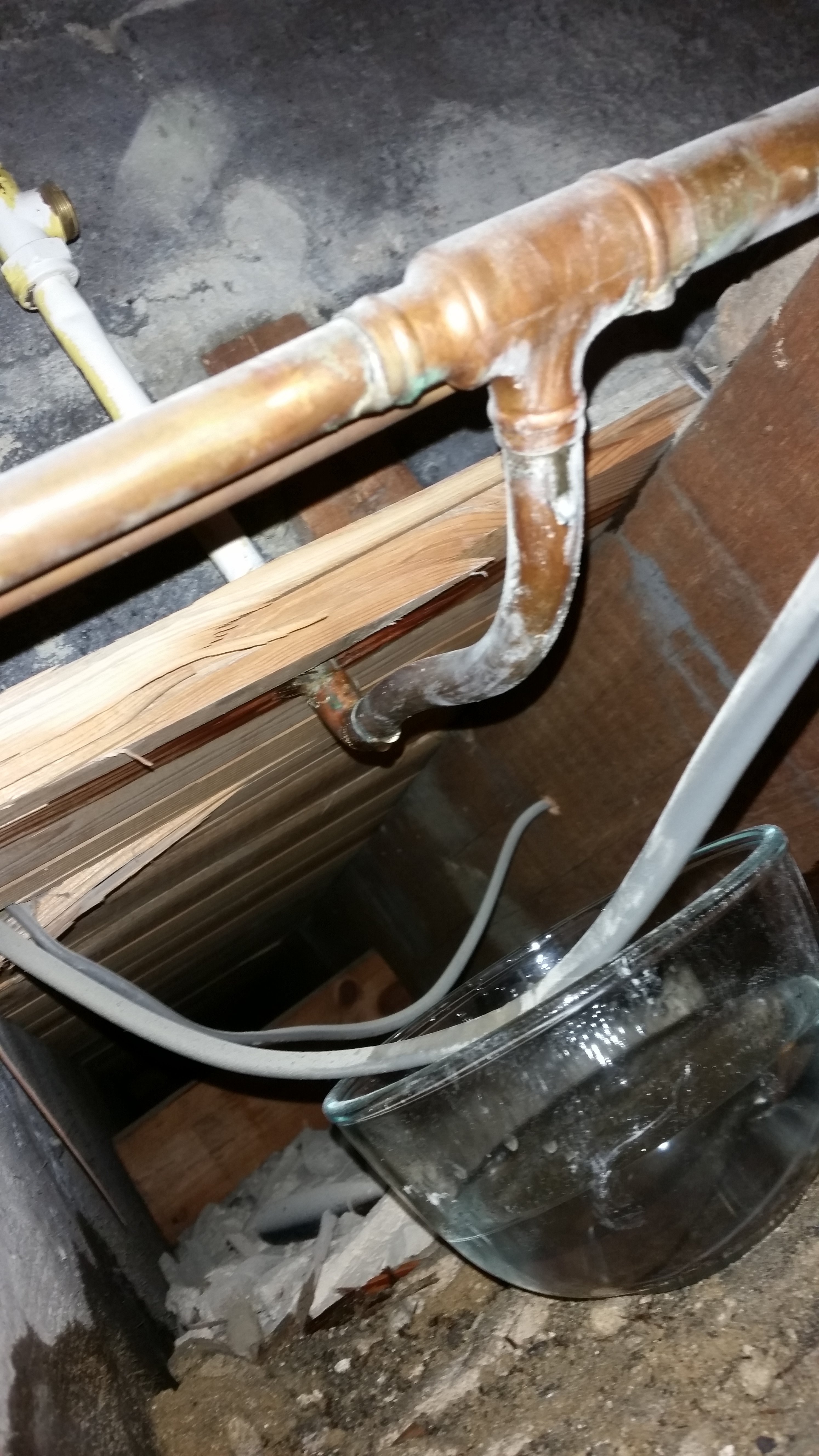

First time poster looking for some advice on a fixing a heating pipe leak.
The leak looks to be coming from the top of the elbow joint in the attach photos. It's only a slight drip every 5-8 seconds.
The pipe leaves the 'main line' and bends under another mainline pipe before straitening up for the elbow that rasies through the floorboard.
My initial thoughts are
  • Scrap the floorboard for access and try patch up the elbow
  • cut the pipe, pull up through hole in board, address leak then couple it back in where it was cut from
  • is pex or pvc a possibility?
I've done research on pipe sweating, push fixings and pex, but would really appreciate advice from experienced people on where and how they'd tackle it!
Much obliged for any replies.
The water is above the floor. So it can’t be the copper elbow underneath.
Have a feel round the radiator valve. It’s probably that.
