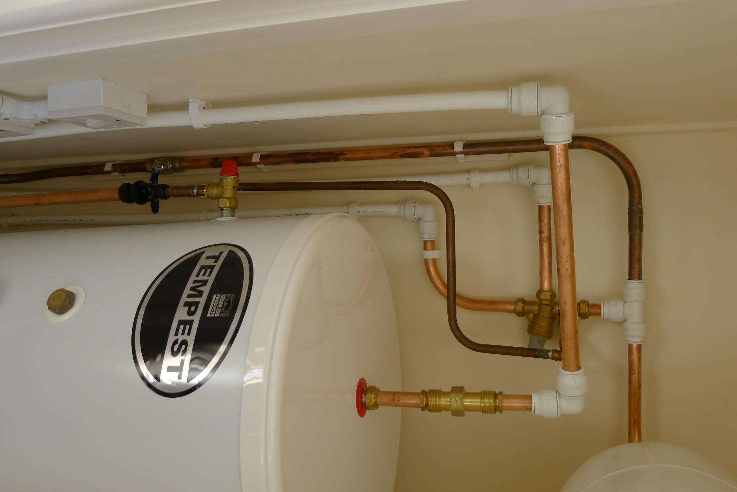

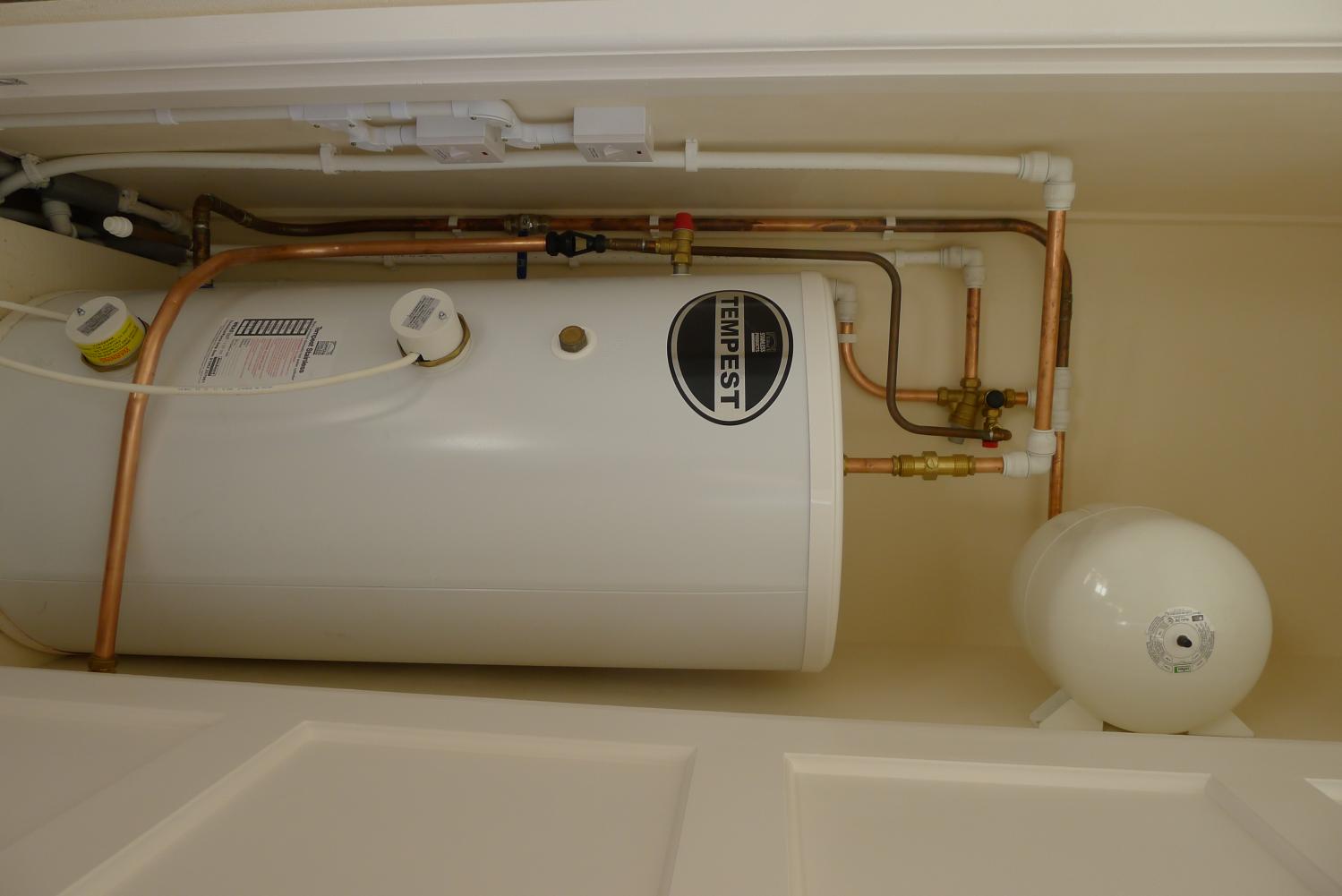

Howsie,
Pictures attached. I have no problem with using Building Control to inspect my work as I have done that before with my electrics.
You will note that the installation is not live yet as the immersions heaters are not connected and there is a stop end on the drain off.
I can describe the installation in great detail to show it's mine.
Constructive feedback is welcome, but not un-constructive comments.
Sorry, talking out of my arris. The orientation of the group inlet confused me!
The service valve if closed will isolate your group inlet from the cylinder thereby disabling the expansion relief and expansion vessel. If someone was to turn the service valve off the cylinder can still be heated and you've disabled an essential safety device.
Expansion vessel also works a lot better upright as advised by manufacturers. Not sure that building control would sign off on something not installed by a qualified individual
