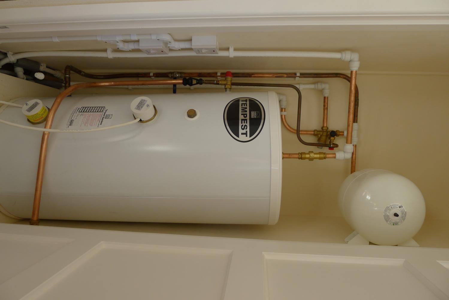

Expansion vessel also works a lot better upright as advised by manufacturers. Not sure that building control would sign off on something not installed by a qualified individual
+1 and they like to breed legionella on their side, no way to fully drain the vessel.
Not as bad as I feared but certainly not done right. Either way, your not qualified to work or install these things so why break the law?

What do you think about the service valve after the group inlet? This is contrary to regulations and is a big no-no for good reason. If the service valve is closed you've disabled a safety device and the expansion vessel too, leaving the T&P valve as the only safety.
I take it you can't solder? All the soldered joints look like recycled pipe.
Not to regs and just goes to show you shouldnt be touching stuff you are not competent to do so.
Iso on cold feed after expansion.
No drain on cold feed, not that I can see anyway.
D1 will always be an issue. Needs repiping.
How longs D2?
Expansion vessel orientation wrong.
No insulation.
Not competent to install.
Doubtful electrics are yours, wouldnt have been in conduit.
Notify building control prior to install?

Pictures attached. I have no problem with using Building Control to inspect my work as I have done that before with my electrics.
You will note that the installation is not live yet as the immersions heaters are not connected and there is a stop end on the drain off.
I can describe the installation in great detail to show it's mine.
Constructive feedback is welcome, but not un-constructive comments.
View attachment 25932View attachment 25932
