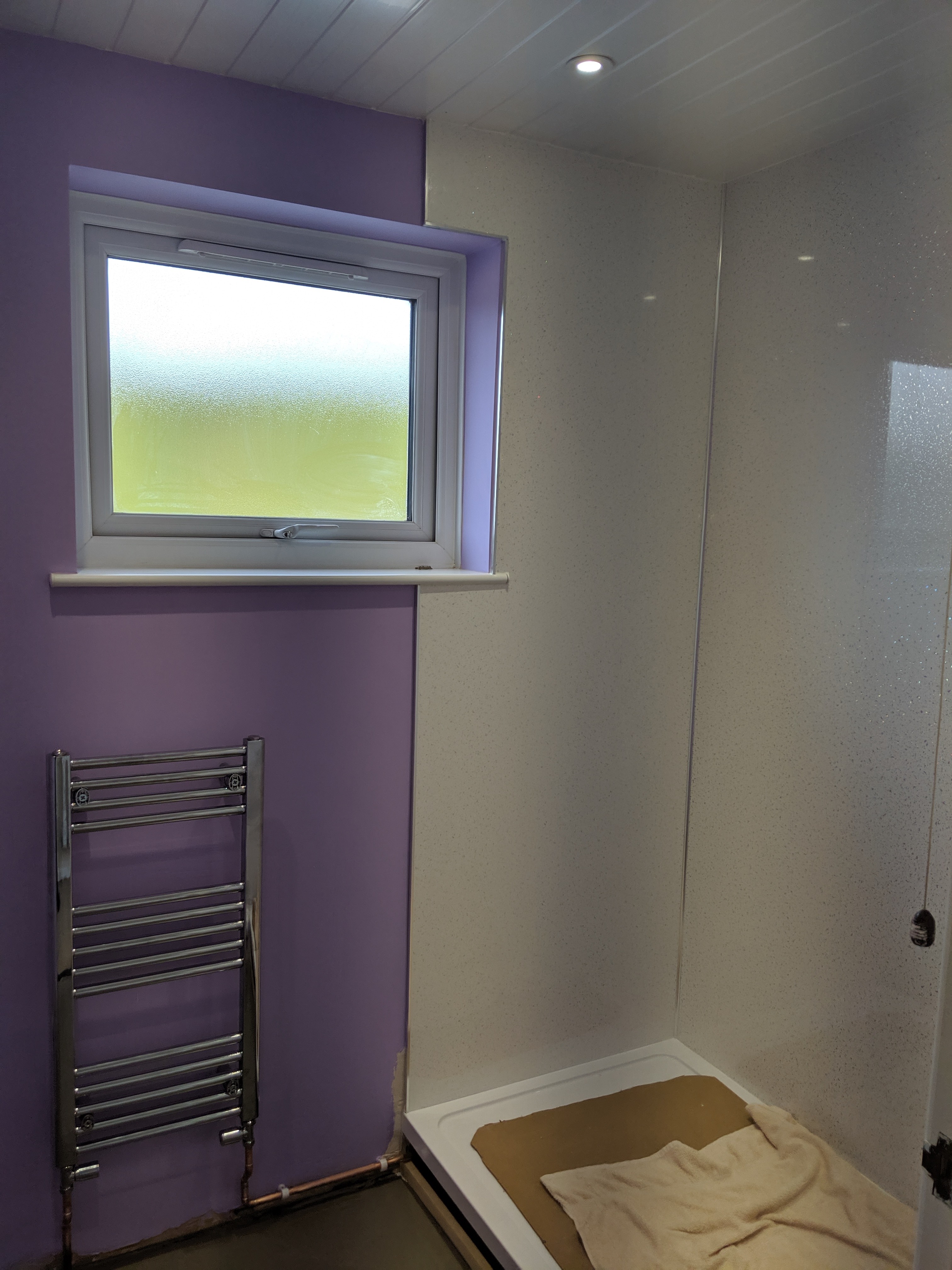

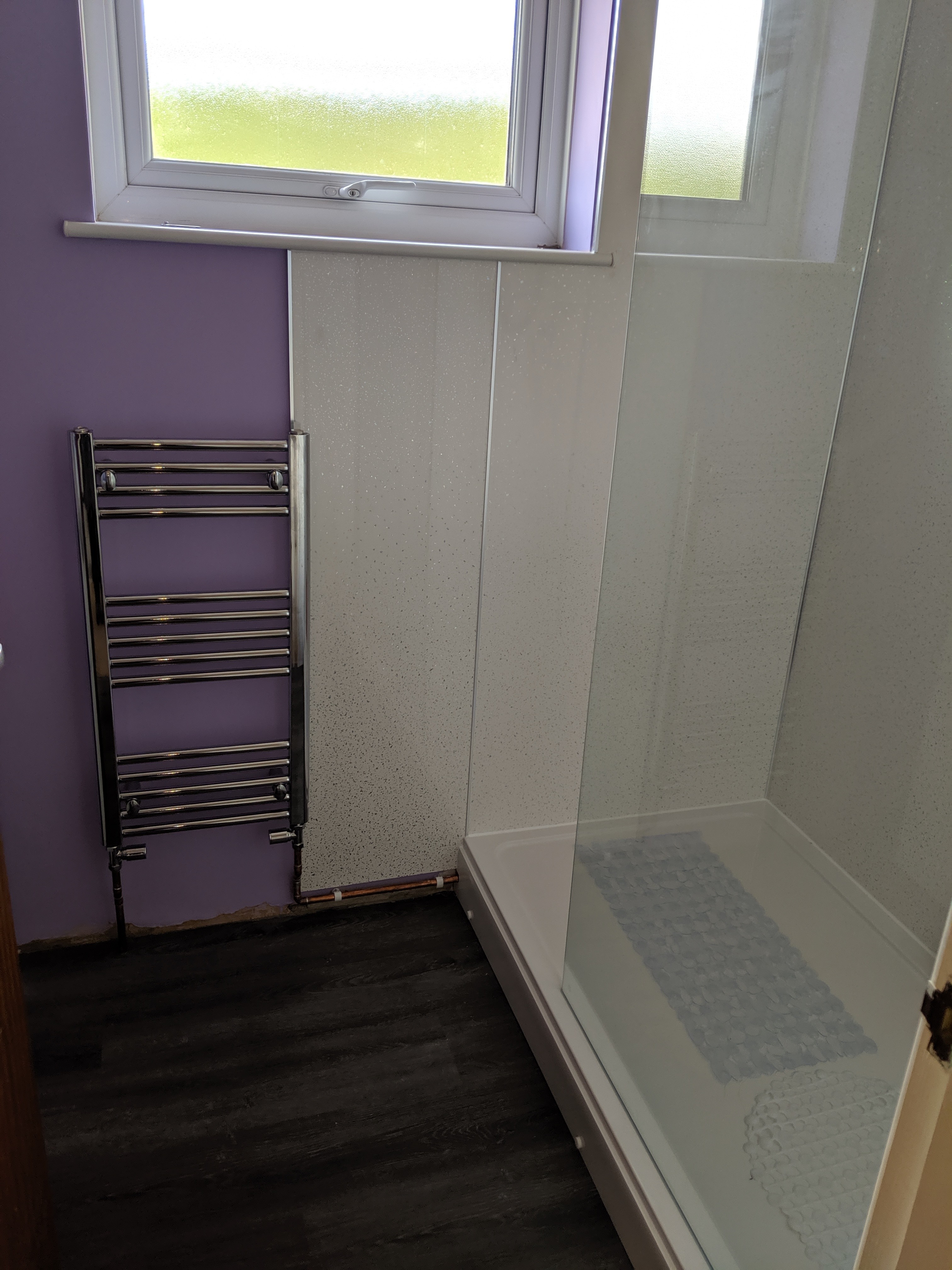

It would be better to leave it slightly proud of the coving in my opion. I just did one I cad the ceiling In plastic from eurocell as Ben gee's recommendation add j trim to finish it if you just want to do the shower area stick up with silicone and staple the tounge before fixing another board . Cheers Kop

Looks really tidy KOP, what is height of top edge of shower tray 120mm?
Cheers Jim
Sorry Jim have to disagree I like a chrome trim i use them on all my installs looks better and lasts longer in my opion , tray height dunno 100mm ish cant use that stupid plastic effort you get with a riser kit . All the best kop
