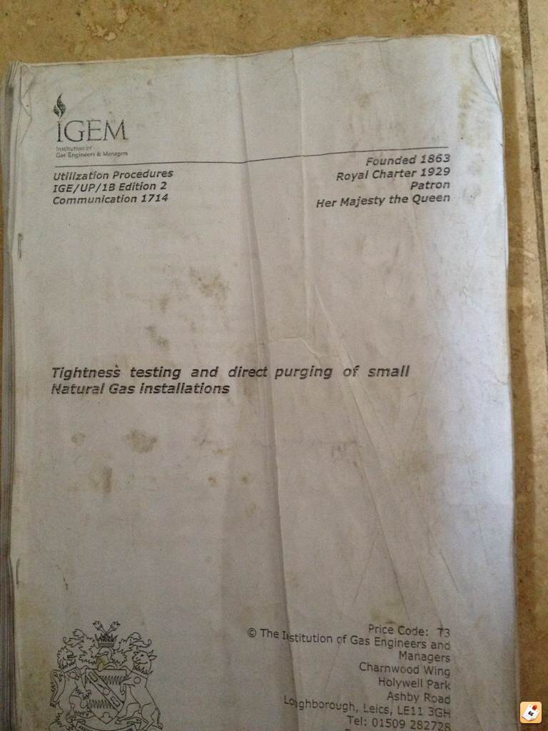

Better re read the regs. Igup/1b - that the old one? Drop on connected appliances ok if no smell of gas. Must verify that it's not on pipework! I can't find my copy on phone it's in van. Anyone have a copy for reference?
If no smell of gas, no need to isolate appliances to confirm where the drop is. Nothing has changed. That's why it is called permissible drop.
Whether you do or whether you don't is engineering judgement, ie down to you and your conscience. Just make sure you get it documented that there is an existing drop to cover your rse.
LPG testing is in BS5842 for small installations and IGEM UP 1A for larger installs.
Found this while looking for a book, it's a s/a eddition.
Does this not clarify what I originally said?
And if like you said you have to confirm the pipework is sound by isolating the appliances, are you then happy to leave an appliance you know is leaking?
For the record i don't like to leave any leak on any job, was just quoting what i'd been taught at college.
