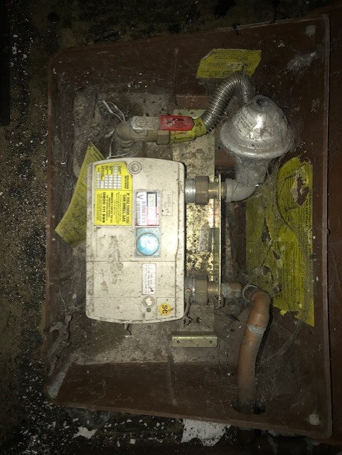

Hi
I'm new here and hoping someone can help.
On submitting a gas meter reading my account is showing as being in debit of £2106.42. I live on my own in a privately rented flat (2 bedrooms). On querying the amount with my supplier it has come to light that since I moved in the supplier has the wrong meter serial number and has been reading my neighbours (also lives on own in a 2 bed). The meter on my neighbours is currently at 3332 and mine is 7906 - the meters were installed on the same date and she has lived here longer than me. The meter reading when I moved in was 1592 (October 2015).
My query is; how can my reading be more than double (it was only last week that I turned my heating on), I live on my own and work full time, also (a little shamed to admit) I rarely use my gas oven.
How would it be possible for our readings to be so different? Back in January I had no hot water so my landlord (who says he is corgi registered) came out and fixed the issue - could he have done something that would give me such a high reading/bill.
I have also been informed that there is no record of my meter on the national grid and that meter has not been serviced since I moved in 3 years ago.
Sorry I'm not able to give any technical information and appreciate what I am asking may not be a straight forward answer but any guidance would be greatly appreciate.
Thank you for reading.

Could be anything. As requested can you get pictures of the meters please. Could be using yours as a primary.

Can you get any pictures of the gas meters?
Hi, thank you for replying. I hope this can help (and has attached correctly.

Stacey, "Your meter" in the picture is outside?
Are there any other meters outside?
Hi, yes all are outside. The café one (which is what I live above) is next to mine and the others are in the other side of the court yard (neighbour whose meter they have been reading) and the hairdressers. I think my other neighbour is on a prepaid meter.

Bet they have the meters muddled still
I've been thinking that, but the GSR-Landlord would have identified the correct meter when he did tightness, assuming he did it back to the meter..
A question to Stacey, is your Landlord the owner of all the flats and shops or does he just own the flats?
I'm thinking that if he's tightness tested all the units then he should be confident which meter is which.
Leaving the only other possibility that the Gas meter is faulty.

Hi, thank you - again. Yes he owns all the flats, hairdressers and cafe.
When I spoke to SSE on Monday they had me turn off the gas from my meter (the crazy meter reading meter) and it did turn it off as I couldn’t use the burners on the oven.
I’ve just checked with my neighbour - she is with British Gas and has lived here a few months longer than me. My first bill (with neighbours serial no on) was with British Gas so is it possible for them to have 2 customers with the same meter serial number?? You’d think the system would highlight a duplicate.

Hi, thank you for replying. SSE have raised a complaint and so I have. They’ve also requested a charter back bill so hopefully I won’t have to pay. If this is not the case then I will definitely be taking your advice, thank you.
My main concern (once the payment disagreement is resolved) that if it’s not determined why I have such a high reading that my monthly bill will be in the region of £95 (as quoted by SSE).
I have asked for a engineer/gas person to visit to check the meter but they are saying they can’t until the national grid is updated/my meter serial number matches my account. This I was told can take up to 10 days.

I’m waiting for SSE to advise if a chartered back bill has been authorised. They have admitted it’s there fault but I’m at a loss as to why my reading is so high - me and my neighbour live on our own, work all day, rarely use our heating and have a massive difference in readings - she’s lived there longer and the meters were installed on the same day.

I was led to believe that the chartered back bill was to clear the 2 thousand pound bill as I’ve been paying £29 per month (but based on neighbours usage/readings). I take it chartered back bill is not this? I have emailed proof that I sent them the correct serial number but they said it wasn’t on the national grid so sent them the number that was on my first BG bill (which unbeknown to me was my neighbours). I am refusing to pay until it’s determined why my reading is so high....they’ve said they can’t send anyone out until national grid is updated but that can take up to 10 days. I’ve sent numerous emails and don’t know what else to do to be honest. Since Monday I’ve not used my heating or oven as worried the readings is going to keep increasing.

When I’ve just spoken to supplier she was shocked to learn that it’s not on the national grid even though I have sent them an email from a member of their team informing me of this.
Just to reinforce my last post if SSE continue to say it's the Landlords responsibility;
A quote from the Database site,
https://www.xoserve.com/index.php/about-us/
How do I change my Meter Information?
Unfortunately, Xoserve is unable to update your address details directly. Xoserve holds the gas supply point register (national database) on behalf of the Gas Transporters which is updated by gas suppliers using electronic data files. If a supplier identifies that a customer address/meter is incorrect then they should submit a request to Xoserve in order for details to be corrected.
Hi, I’ve spoken to supplier today and again asked the question of ‘has my meter not been looked at for the last 3 years’ and was advised that every 6 months engineers look at all meters in their area even if they do not work for the supplier that provides the gas. Is this correct? I have in my head a picture of seven dwarves doing the checks from the goodness of their heart 🙄
Hi, just the one from British Gas. Can I ask, why you’ve asked? I’ve been asked to take meter readings for the next 5 days.
Historic bills would show consumption over time ........... and whether they were using estimated or actual readings
Historic bills would show consumption over time .. and whether they were using estimated or actual readings
It’s a quarterly bill where I submitted the reading on me moving in and the final reading (one that I gave current supplier). Could 3 months usage be helpful for me to submit the the supplier do you think? Thank you again for replying.
That depends on what the 3 months consumption says
How long have you been in this flat?
Hi, sorry for late reply - for some reason I didn’t receive an alert. I’ve lived in the flat 3 years.
I’ve been asked to take readings from the supplier every day until Sunday - the reading is going up by one everyday. I have not had the heating on everyday neither have I cooked everyday...not sure if this reading sounds about right??
If you're not using any gas appliances the meter should not be showing any increase but it is, that is what you should be communicating to your supplier.
