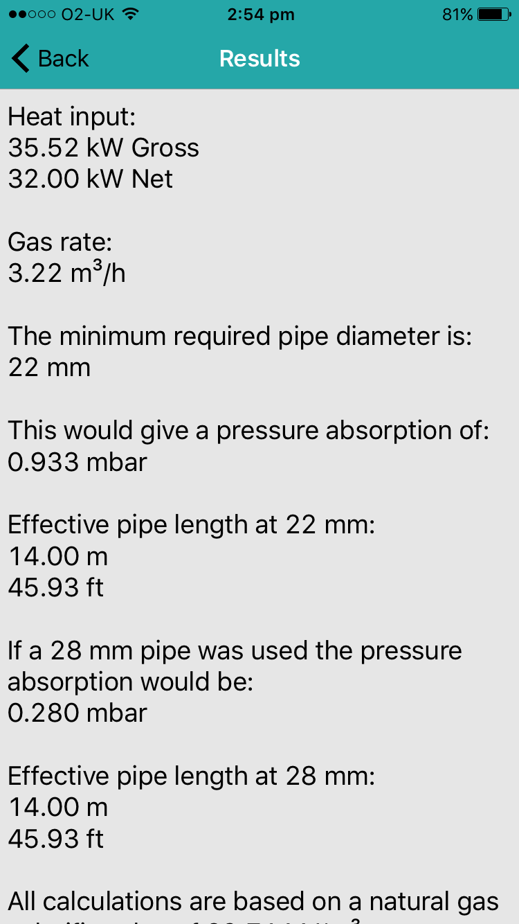

I've over compensated with my calculation and 28 is more than enough to feed 3.75m3h. Also, why would they put a 15mm gas connection in a 30kW boiler? Hate Vaillant!

The most I'm ever gonna get from that small section of 15mm is 2.9m3/h - anything higher needs 22mm - why would Vaillant ship a 30kW boiler that needs a nominal flow of 3m3/h with a 15mm connection??? Or am I missing something here (wouldn't be the first time!!)
Nope your looking at the tables wrong. That 2.9m3 refers to a 3m length of 15mm with a 1mb drop.
A mere 20 cm section would flow alot more than that...by my loose reckoning easily in excess of 5m3
