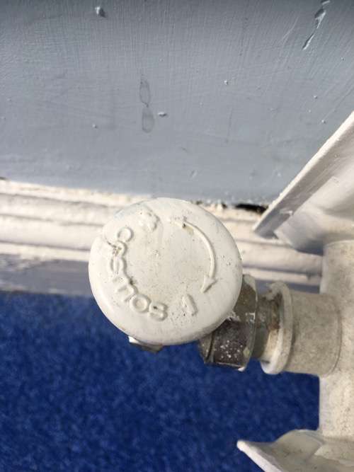

Hi guys, I have spent days getting prepared to remove a radiator. Have watched youtube vids, got a list of step-by-step instructions, some really good information from this forum and am all ready to go... and I have fallen at first hurdle!!! Everyone says the lockshield cap just pulls off. This was doesn't. It's not a pointy cap, it is plastic but has a + and - on it. I tried giving it a gentle pull to see if it will come off, but I don't want to brute force it just in case there is another clever way - though can't see how. There is a TRV on the other side. The radiators are old - not sure how old. This one hasn't been used since we moved in, as it had been painted and when we turned it on it stank, so it needs to go. Initially I just want to get it off the wall, as I am removing skirting boards, and have a plasterer coming in a day or so. Will get a pro in to move pipework and fix a new radiator in different part of the room at a later date, there are other radiators to be replaced so will have it all done at same time.
Here is a pic of valve, which I am assuming is a 'lockshield' as there is a TVR on other side - it moves freely in either direction, but doesn't seem to come off, at least not easily.

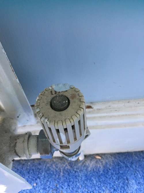

This is the TRV on the other side

Turn it all the way fully clockwise to shut off, be warned with the age of those valves they may leak once disturbed.
Thanks for quick reply!
Should I still be looking to pull the plastic cap off? Or just leave in the minus position all the way clockwise?
No you can turn the spindle with the White cap (like a normal tap)
I've just pulled it off. Noticed my other radiators had the same valve and they came off easily, so approached it with more determination.

Really? I would have put money on that trv not holding.
