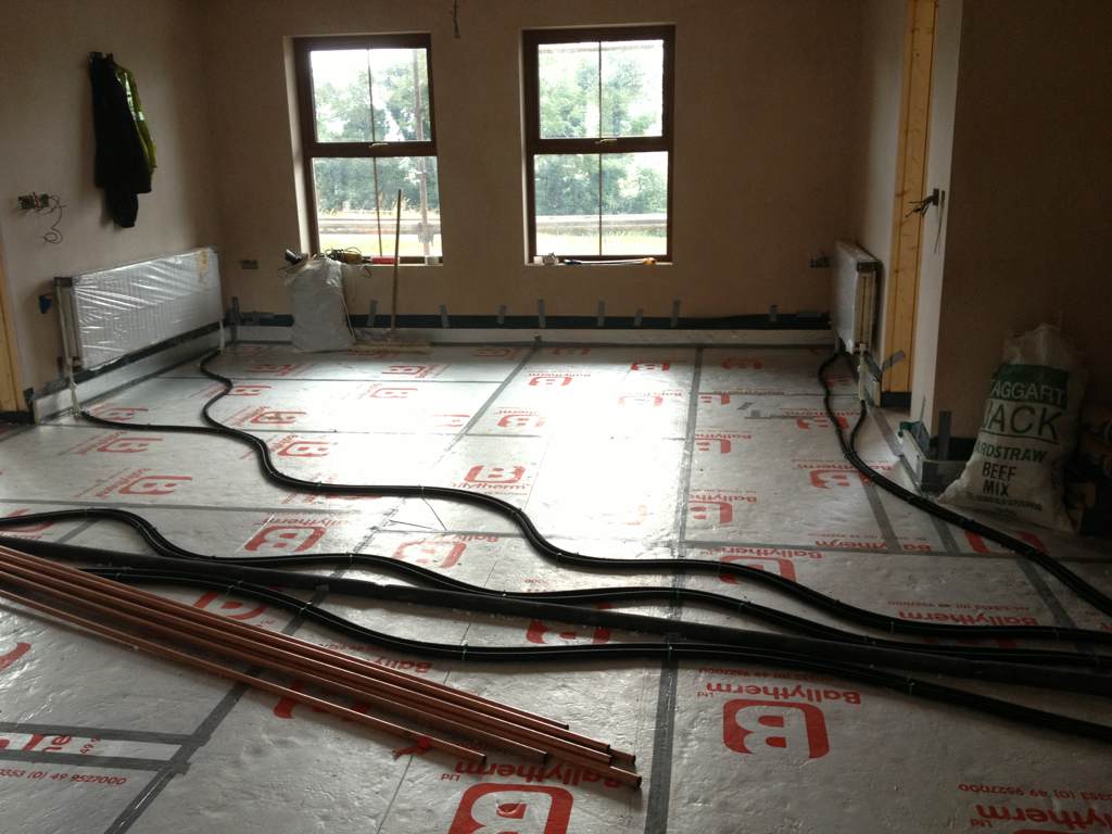

My house had no central heating when I bought it last year. I fitted a system of plastic to the rads, and then a length of copper with a chrome plated tail to the rad (chrome plated pipe, rubbed back and soldered to the copper).
Looks nice, hasnt leaked. Went in much quicker than copper, and cost less money.
